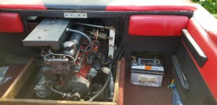

I have a boat that i am restoring for about 3 years now, and because my old mercruiser engine was beyond repair, i bought a new (well, when i say new i mean new for me, but older then me ;)) volvo penta with transmission. I figured out, based on forum posts that my engine is a AQ130C, that should have around 130ps (the old mercruiser had the same).
Now, i know that my transmission is a 250, but i have no idea if it's 250a,b,c ... and can't find how to figure that out.
My boat is a 1989 Regal Medallion 185, 18ft bow rider that is pretty heavy.
And now the problem, the boat just won't plane. I had the engine a full service, and now have excellent compression on all pistons, and the engine runs excellent, but still, the boat just does not plane.
Did some water tests the other day, and with just me in the boat i can go about 21mph, with 2 i can go about 18-19, and with 3 16-17mph. p.s. my tacho is broken, so no idea what RPM...
So, i figured that because the engine + transmission + propeller used to be an a slightly smaller boat i probably have to change the propeller. It took me 4 days and some bent metal to get the old one out until i found an older forum post that sad to use some penetrating oil.. so that did the trick and now i know i have a 14 / 18 propeller.
Where i live, boating is not that popular (we only have a few lakes) and have no shops around that have propellers in stock (btw, my propeller spins counter-clockwise) so i can't test out what to put in, and shipping costs me more then the propeller if i want to return it.
Soooo, after all this long story we can say that i am in a little pickle ;), and i do need your help.
a. how can i figure out what ratio my trans has?
b. what propeller should i put in? I don't care for speed that much, the lake only has about 10miles, so getting somewhere fast is no issue :rolleyes: but i do want to be able to plane wit 4-5 people on board, and maybe from time to time tow a tube or something.
Any suggestions are more then welcomed !!
Thanks :)

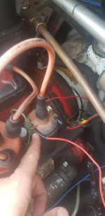

The OHC 4 cylinder engine's ignition distributor is prone to advancing flyweight corrosion and/or rust.
When this occurs, the mechanical advancing system may malfunction, not giving the engine the proper ignition spark lead (aka advance).
If the engine does not see the correct progressive and total spark lead, if will suffer regarding performance and power.
See your OEM service manual for the correct ignition advance curve and verify that your ignition system is delivering it.
If not, that may be part of why it is not performing.

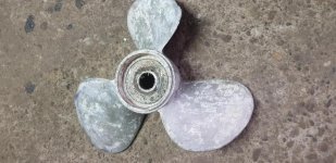

You may need two different pitch/diameter propellers.
One for cruising and one while pulling the tube.
As said, the only correct way to learn which prop is correct for your boat, will be performing the WOT RPM test.
The test must be done with the boat loaded as you intend to use it. In other words..... if you test with no load and use a XX prop, that same XX prop will NOT be correct with a heavier load.

I also thought the distributor might need work, and i actually went to the local boat-repair shop and asked them to give that a look. But they said it should be ok, but i am not 100% sure.
Thanks for the heads up, i will give that another look, and consider replacing the rotor if needed.
But, as i said, the engine seems to work very well at this point.

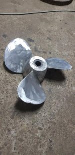

I understand that the ideal situation will be to have the option to try out some propellers, but unfortunately there are no shops in my area that have the propeller that i need in stock, so that means that i have to import one, and the costs of shipping + returning will be almost the cost of the propeller. So, i am doing as much research as i can so that i try to get it right from the first try.
As i said, the one i have now is 14 x 18 L
At this point i am thinking that a 15 X 15 , probably stainless steel is what i want to go for. What do you guys think?
I also thought about a 15x13, but that pitch just might be to low i think.
If i get a good plain with 4-5 people on board and a 30mph top speed, i will consider my self very happy at this point!

The tachometer's signal wire will come from the - side of the ignition coil.
I just been to the boat and located what i think is the connection that you mean (i have attached a photo - the red wire, that i point to, is the one that i connected to the tachometer, can you confirm that is the one?). I got it connected with the tachometer, but no change in RPM... so that could mean 2 things: i either got the wire wrong, or my tacho is dead and need a new one.

Yes, the size and pitch did seam weird to me also. I have also attached a photo of the prop indication.
Nice chart, but unfortunately my engine has much less horsepower and different ratios, so i can't really use it :(
According to the internet, my boat is about 2200lbs, and should work fine wit a 130hp engine...
Since i am in photo mode today, i am attaching a photo of the boat also.
Thanks again for all the great help!
No, I cannot confirm from the photo.
Just make sure that it connects to the side with the - symbol..... and not to the side with the + symbol.

Also, did some work today. I got the propeller of, and started looking for the markings of the ratio on the prop shatf bearing carrier... and just as i was going to give up, i found it-> 2.15 as Rick anticipated! So that's one problem out of the way.
Also checked kimcrwbr1 trick, and it did work, when i put the wire on a - the engine stopped. So at this point i am thinking my "repaired" tacho is not that repaired :D will test out a tacho tomorrow.
And because i got the propeller of, i did some work to it. And while working on it, and seeing the amount of damage it took through the years i decided that i will not go with SS, i think it's to much of a risk, especially on the lake i go on.
But it did manage to get the propeller in a very decent state, and i got all the ugly bumps out, and cleaned really good. I actually really like the new brushed aluminum (see the photos below with the before and after) and i am very curious to see if the repaired version will make a difference

Regarding the AL propeller, as stated earlier, working on my propeller made exactly the point you stated, so i will go for AL.

ok, so i managed to get a working tacho (cost me 3$ from an old car ;):D) and went for a short run on the lake:
https://www.youtube.com/watch?v=xMLEAtgxI2U
So, with the freshly fixed,old propeller, with only me in it i went 24mph at 4000rpm.
Very curious to see how the boat performs with the new 15x15 that should be here next week.

Ok, quick update from the lake... installed the 15x15 solas prop... now i can only go 3000rpm... i can't understand...
And also is very hard to go right, and very easy to go left.... ?! ....

1.the prop is too aggressive.
what i know: with the 14x18 i can go 4000rpm and 23mph. (only me on the boat)
with the new solas 15x15 (i actually found somewhere that it's 15.5x15) i can go about 18mph at 3300rpm. Both with only me in the boat, adding people only makes it worse. That is very strange for me, and i can't really understand why. I've tried all the 3 positions for the stern drive (the settings for the trim i mean), and I've also tried it with or with ought the hydrofoil that i have installed. It did not make much of a difference.
Why this is i really can't understand. Could it be the difference in diameter? (14 to 15.5 ? )
Should i return the 15x15? i only have about 2 weeks to do that. Is there any point in keeping it?
p.s. i installed the 14x18 back at the end, just to make sure that nothing changed with the engine, and had similar results as before.

5. The engine is not fit for the boat.
As mentioned, this is not the original engine. My boat came with a 130hp mercruiser that was beyond repair. I have bought this volvo penta + sterndrive that i thought is similar with the mercruiser. The papers that it came with say that it has 95.5 kw (almost 130hp) and all the clues lead me to believe the engine is a volvo penta aq130 (dual solex carbs, and the shape fits - see the photo).
When installing it i made sure the cavitation plate is just a little bit above the bottom of the boat.
The internet says that my boat has 2200lbs (1000kg), could i just be under-powered, and maybe whatever i do this engine will not be able to push the boat at a decent speed?
6. Anything else?
I am thinking maybe the boat could have water somewhere in a hidden place that is making it to heavy. I'm thinking of finding some way to measure how heavy she is.
Is there some kind of a hidden gem that i can't see and destroys all the balance?
Is there anything i'm missing that anyone can think of?

3. the engine is not in full tune.
The carburetors have been cleaned and set up to factory settings.
The spark advance, has not yet been tuned professionally. My bad. But i did try different small tuning on the lake, and is now at the best possible setting i can find. Ok, i agree a fine tuning is needed, but that could not make a huge difference. Maybe i could go from 23 to 25mph, but it can't do miracles.
Is there anything else i can tune?
That is Incorrect! Ignition timing is critical. Look up your OEM ignition advance curve and make dang sure that your ignition system is delivering it as per the specs!

Could i have a bad distributor maybe?
Yes.... very possibly. You will not and cannot know until you roll your sleeves up and check it throughout the RPM range.
Possibly. You have chosen the older Volvo Penta 4 cylinder push rod engine. These are not powerful engines.
You would have done better had you chosen one of the Volvo Penta OHC 4 cylinder engines.

Be sure to check the ignition advance at idle, at 1,000RPM, 1,500RPM, 2,000RPM, 2,500RPM and right on up to the RPM at which it quits advancing.
Compare this to your OEM advance curve.
