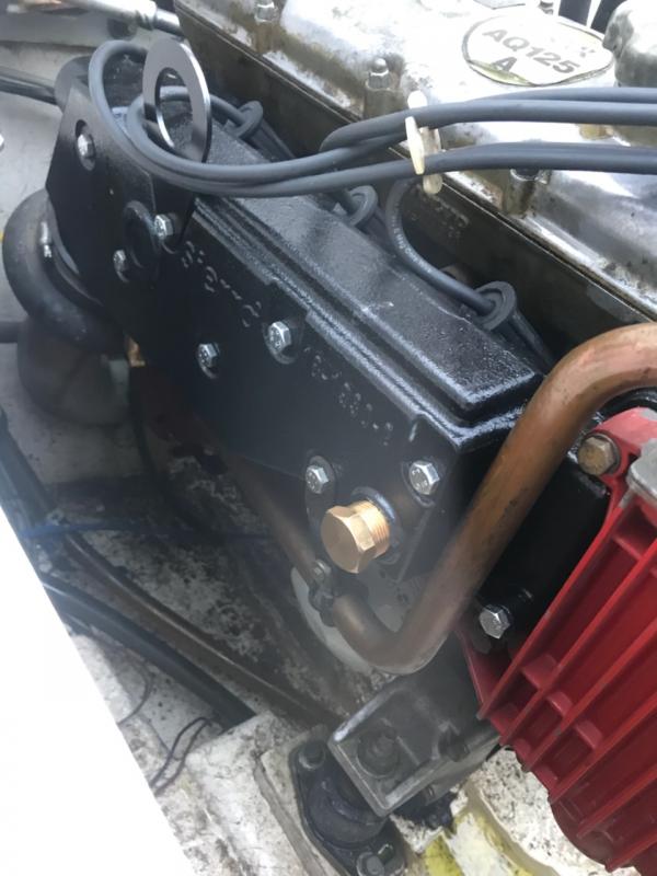

the new manifold had a port on the side and came with a big brass plug with another thing attached to it, my old manifold did not have this port on the side. I installed the new one and everything fit good, started the engine and it ran fine however I am getting some smoke in the exhaust and the new exhaust manifold gets really hot. I am wondering if this manifold is the wrong one for my Aq125a? I assumed since I. And with plug that I could just plug that hole? Can anyone offer suggestion?
That is the correct manifold the brass fitting in a drain petcock. You need to drain the water out if it freezes in your area. Sounds like you need to figure out why it is not getting water. Water should flow free out the exhaust shortly after you start the engine.

1. please see attached picture of new exhaust manifold, as stated this one has a big brass plug on the side that my old one did not, it does have the brass petcock on the bottom for draining in addition too so not sure if this is for a water heater or what. Additionally the new one does not have a "split" plate at the exhaust plat internally.... the old one had the exhaust split with internal plates and this one does not appear to have any... when engine is running the bottom of exhaust manifold will stay cool but the top get pretty hot darn hot. I am still concerned I do not have the right one? but on to question 2.

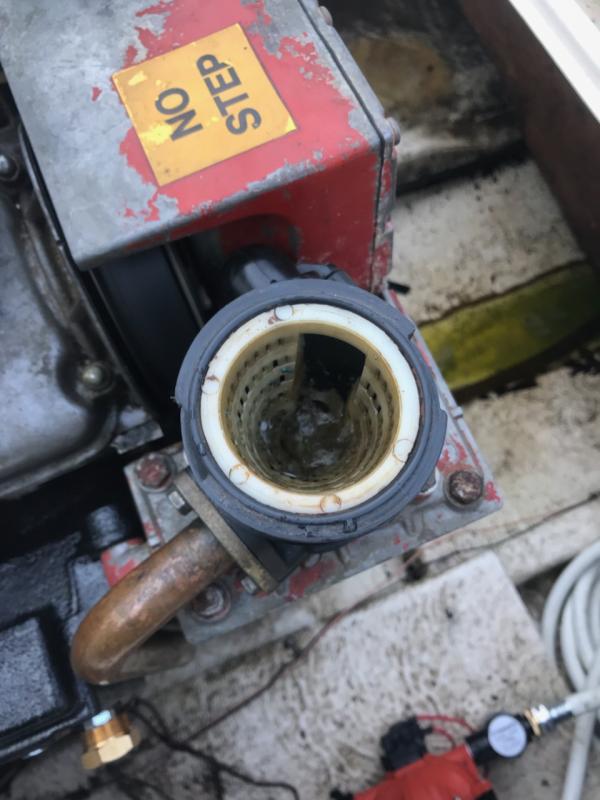

2. replaced impeller, water gooseneck piece in outdrive, hoses, O-rings ect. but at idle speed I can take the cap off of my sea water strainer and watch the water pump... it does not pump very fast at all and surges up and down but doesn't overflow with cap off. Obviously when I increase RPM's she pumps faster, overflows ect and at that point cools down the exhaust manifold nicely but I a worried it is not pumping enough at idle speeds and that is causing exhaust manifold to get hot. Is this normal I checked belt tension and that appears fine, as well as replace the rubber key piece on the impeller shaft that connects the two shafts together. Any Suggestions on this one?
