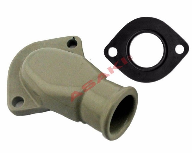

I got the boat out of the water today and removed the S-hose and water neck. The S-hose is not damaged at all, but the water neck is not in a great condition whatsoever. The part that is covered by the S-hose is partially broken, which might result in an air leak. We however performed a test where we put positive pressure on the suction hose while the seawater inlet was covered with tape. The S-hose and connectors were covered with soapy water, and we didn't see any air bubbles. it might be possible that a test with negative pressure would result in a different outcome.
We'll replace the water neck in the hope that this will solve our problem. I attached a photo showing the broken water neck. Do you think that this would solve the problem, keeping in mind that we didn't see any air bubbles during the test?

Today I bought a new water neck (the REC854031 for the Volvo Penta AQ200-290 sterndrives) and replaced it for the old one. I made sure that the water neck (including rubber gasket) and S-hose were properly installed. Unfortunately, the engine shows the exact same signs as before the replacement of the water neck.
The testing conditions weren't ideal however. We put a big plastic box filled with water underneath the sterndrive (see photo. When we ran the engine the waterline was to its maximum height). During the test, the seawater inlets were beneath the waterline at all times. After two minutes of running, the engine's temperature began to rise again, and I shut down the engine when the temperature exceeded 75 degrees Celsius (normal operating temperature should be 60 - 65 degrees Celsius). After shutting it down, the temperature raised even further to 90 degrees Celsius.
So did we apply an incorrect test or is there still a problem with the sterndrive/engine? Again: the impeller spins, the thermostat opens up at 60 degrees celsius and there is no blockage in the cooling system. I'm really lost at this point, I hope you guys can help me.
