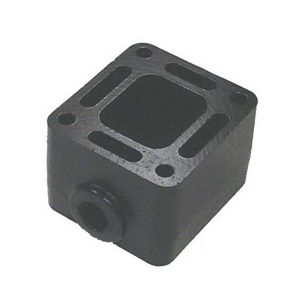

Your 290A exhaust system will not use risers (risers/spacers will not work with this exhaust system)........ you should have manifolds and elbows only.

With your exhaust system, the Elbow's down angle and the OEM Y-pipe alignment and connection will not allow for Risers/Spacers. A Riser/Spacer would cause a misalignment of this connection.

Yes, many companies will call an Elbow a "riser"...... it's similar to calling an Engine a "motor" ...... so to speak.
Perhaps think of it this way:
if this component was a "riser".......
..... then what would this component be?
