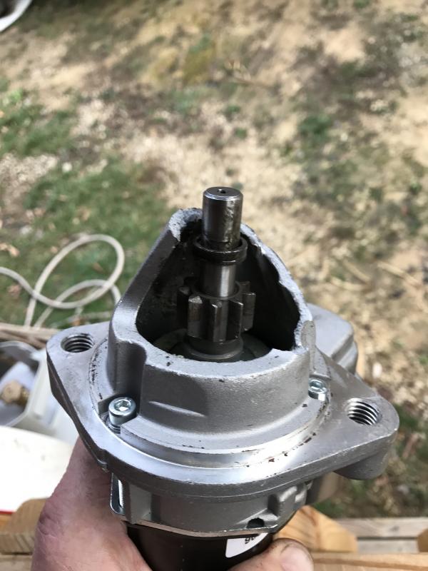

i bought a boat,1986 glasstream that has sat open for 3 years. has a Volvo aq131a sterndrive, boat look good inside and out. motor was locked up initially ,but got it broke free finally. dropped oil plug, and had more water in it than oil. got all that lined up .had some electricl issues, but got that lines out too. finally started after new starter motor. after running a few minutes,started making a grinding high pitched noise. then died. tried ti restart, but only made a grinding noise from starter. pulled starter, and about a 3rd of tip of starter motor was broken off. do i have to pull motor to retrieve broken starter tip.also i suspect it may need new crnk bearings from grinding noise i initally heard.

finally,think I got . pic of starter
If you can take a mirror and inspect the flywheel teeth good I couldnt imagine what would cause that other than a defective casting from the factory. Did you try and piece it together to see if you got all the bits out? I suppose it is possible a bolt or something in there got bumped up when it was running. Inspect the flywheel good or pull the engine and just replace the flywheel while it is apart?

yes going to replace fly wheel,,damper and bearing and bolts. and greae it all up before dropping it back in. I think the damper has a metal piece missing and may have been fishes out by previous owner. nothing else would have caused that much scarring on bell housing. exhaust hose good also. thanks a bunch !

I didnt think of the damper possibly losing a piece/s get jammed in the starter but it is possible that would make one hell of a noise I imagine to bend the flywheel bolts.
