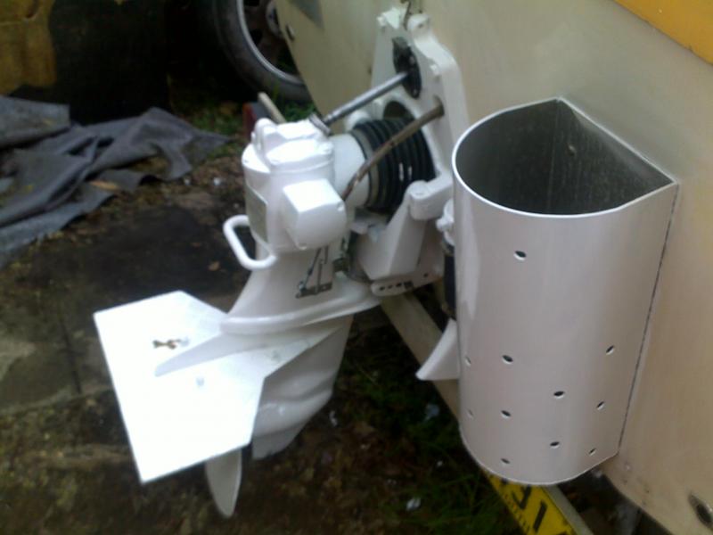

Mine I would say is the 100 or the B , remember Im in Australia, Im sure the motor and leg in my boat is the original setup when it was sold new, our models here can vary to USA models etc, Ive just painted the leg andits wet but when It dries Im going to pull the dipstick from the top of the drive and see if its diff oil or engine oil, if its the heavy diff oil its a 100 if its thinner engine oil its a B that's not to say some wanker has drained it and put the thinner oil in it, they do **** like that in the back yards, Ill keep my eyes out for a replacement later leg these older style legs aren't that common here and your still paying 1500 bux just for the upper gearbox second hand off the leg so a complete second hand leg would cost maybe 3 or 4 thousand and that too me is prohibitive. Cheers and thanks mate.

Thanks Rick, I have removed the dipstick and for all intensive purposes Id say its the 100B, its not standard old stinky diff oil in there and its clean and no signs of water in the oil, next on the to do list is to remove the top half of the leg and do the bellows and find out once and for all the model of the drive, the early 100 looks like it uses a constant velocity joint?
