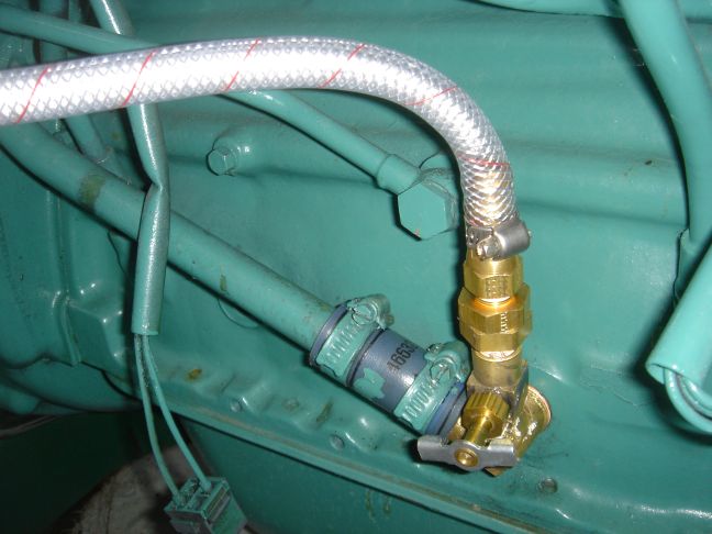

You might want to try a modification of the turbo drain elbow. I did this thinking I was smart, and in my case was unnecessary.
In your case it would force pressure on the crankcase to vent via a racor filter, trapping the problematic oil overflow.
This would be useful for you until the source of the problem gets corrected. Your problem has to do with something pressurizing
the crankcase. Maybe somehow the turbos exhaust?
In fact I m in the process of increasing the width of the breather pipe to the air filter similar to the second image. Hopefully this will improve the vent and correct the problem.
