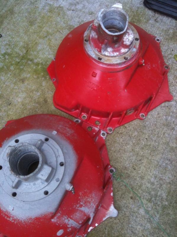

Here's what may happen if/when the AFT-most bearing were to fail.
This is just the potential damage that can occur to the F/C.
Additional damage may also occur to the Universal Drive Shaft!
And on a bad day, it can take out the transmission's Bearing Box Clamping Collar. :mad:
