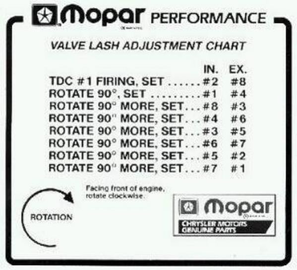

I have a 1964 Fairliner that has twin 318's I had all the heads redone, ready to put back on. Need to know the valve Lash settings.
I was told .017 by a local mechanic just off the top of his head. Any info/ tips for the install would be greatly appreciated.
