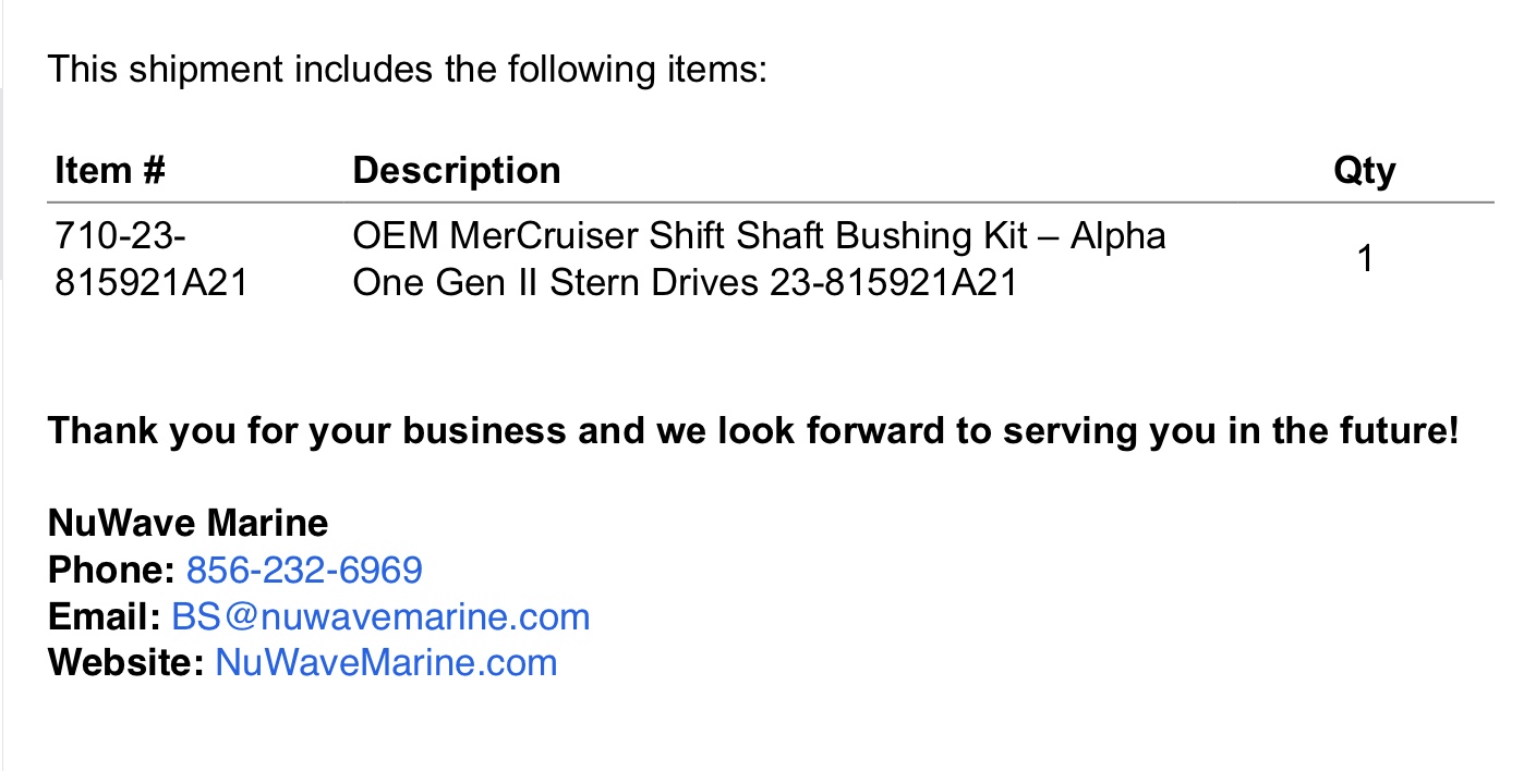

No. So I guess replace the seal assy again and while it’s off, replace the lower water pump seal then retest.
yes. Also with a merc shift shaft seal - they sell the plastic housing with the seal in (bushing assy) it and the seal alone... to save $10 I bought just the seal.... I could not get the seal to stop leaking in the old housing (bushing assy) even using permatex #3.
Bought a new housing from powerboat supply.
