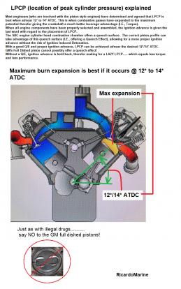

Here is an updated image that better explains LPCP.
Since LPCP is critical for performance, it becomes even more important to incorporate a Q/E into your SBC Marine build.
