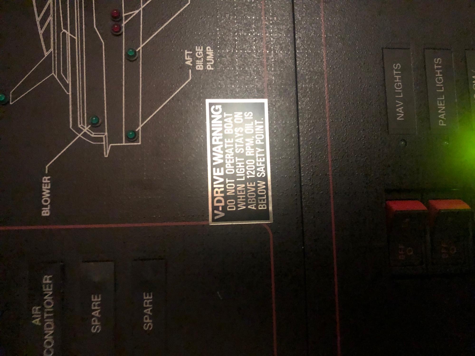

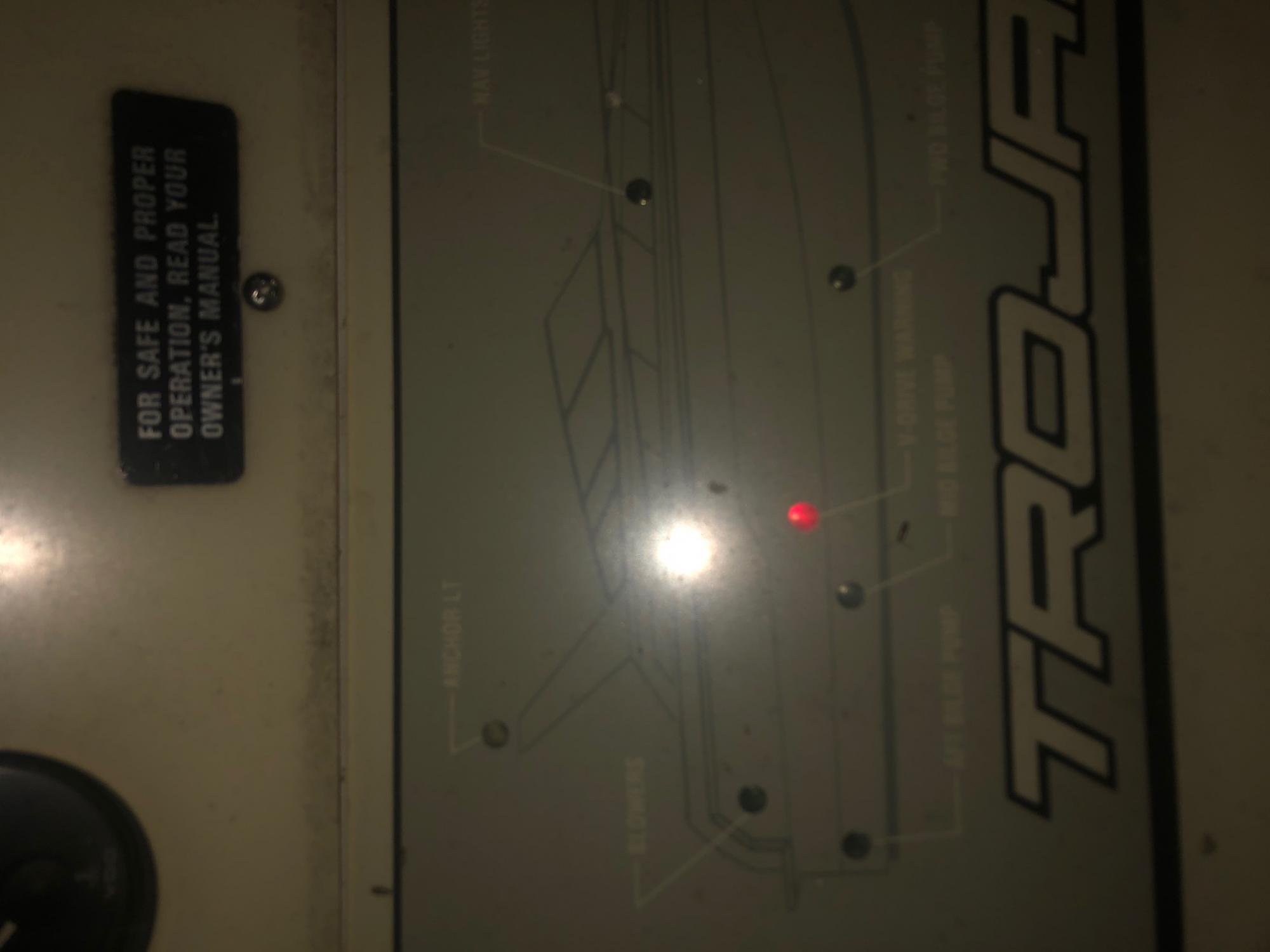

1) Issue 1 - port motor has a V-drive warning and I can't seem to clear it. Interested in determining how to clear the code (engine scanner doesn't show anything), and if possible, how to jump out the warning so it goes away, even artificially. I've read some conflicting information, that the waring is related to fluid level, and some that say that it's related to fluid temperature.
I've read that the proper way to clear the code is to drive at 1,500rpm, and the warning will go away. Did that yesterday, and it didn't work. The warning seems to be messing with the operation of the boat. That motor falls on its face right at 2k RPM. Is that correct? Seems to go in a "safe mode," right at 2k RPM.
