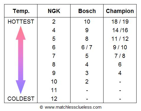

  32. After months of testing, we ended up putting in another new set of spark plugs (NGK BPR6EFS) as the others were going black. This appeared to be carbon build-up, possibly from running at idle alot and/or motor running rich. Maybe something else?

I just checked the NGK part number and those plugs look a lot longer than the OEM AC Delco MR43LTS plugs. I understand that the AC may be hard to find and some places tell customers that they're impossible to find (they're not), but the cross to NGK Iridium is NGK-7397.

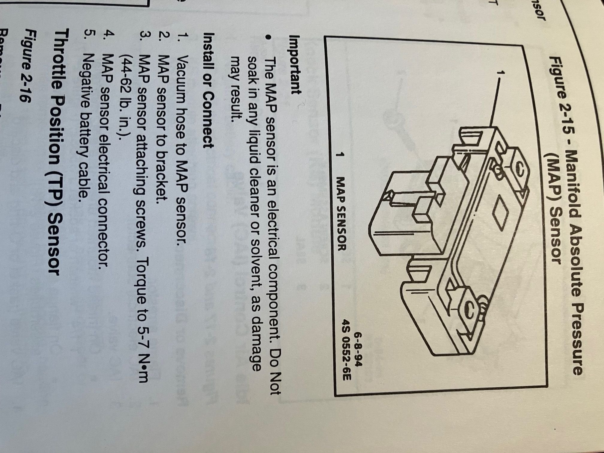

MEFI I, on a 1999 engine? Are you sure about that? Can you post a photo of the ECM, MAP and Knock sensors?

ECM is definitely a MEFI 1. It is a Delco 16220371. Engines may be 1998, boat was delivered 1999.

I'll try and get pics of the sensors and post those too.

I would definitely compare the ITR4A15 plugs with an AC MR43LTS- if the NGK is longer, check the ground electrode. I would check all of them-the gap, condition, evidence of running rich or lean, etc. The plug wires are a possible source for the problems, too- they don't last forever and I have used wires, cap/rotor that come with lifetime warranty because of this in boats AND in my personal vehicles.
While you're getting photos, can you post the ECM, MAP sensor, Knock sensor and wire colors for the relays?
Make sure the MAP sensor tube doesn't have liquid in it- that can cause odd issues, especially if the sensor is mounted low.
In this case one of the main things that is incorrect regarding the spark plugs is that the heat range that was installed temporarily by using ITR4A15 is ‘it is/was a bit higher (2 numbers hotter) vs the recommend AC MR43LTS or more widely used after using the AC, NGK-BPR6EFS… With NGK, the higher the number, the cooler the plug range… with this engine model, I’d recommend only using the ACMR43LTS or NGK-BPR6EFS.
May I ask, what did you find wrong to repair the lower voltage readings?
If MR plugs are hard to find, CR43LTS can be subbed, M stands for Marine, C stands for Commercial vehicle
Some places say the MR are hard to find, but after wasting a trip to one place, I found them less than a mile from my house, at what used to be Quest- it's now Advance Auto Parts.

If the MAP sensors are the same, swapping them might show that one is faulty. Also, a vacuum pump can be connected to the sensor and pumping a couple of times (no high vacuum) should cause the voltage to vary- the sensor doesn't care what's creating the vacuum,. so if the pressure matches the other engine, it should make a difference on the engine that has a problem, assuming the vacuum isn't correct.
If some kind of liquid is in the tube going to the MAP sensor, it can alter the reading- disconnecting the tube at the sensor while it's running should clear it, but the sensor may need to be removed and positioned so any liquid can drain out. Also, the attachment is from the Mastercraft manual and shows that the sensor shouldn't be cleaned with liquid cleaner or solvent.
