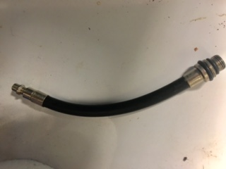

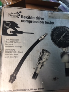

If you can get a hold of one of these screw in compression gauges and an air compressor, you can use 100 pounds of compressed air to force the penetrant into the rusted area. The fitting is a standard 1/4 m and is compatible with the fittings on my compressor. The pressure also puts a heavy down force on the piston (600 pounds on a 3 inch piston) without doing any damage.
View attachment 16412View attachment 16413
If you can get a hold of one of these screw in compression gauges and an air compressor, you can use 100 pounds of compressed air to force the penetrant into the rusted area. The fitting is a standard 1/4 m and is compatible with the fittings on my compressor. The pressure also puts a heavy down force on the piston (600 pounds on a 3 inch piston) without doing any damage. View attachment 16413
Great tip! I would have never thought of that (and I have all the required elements) thanks Bobby!
