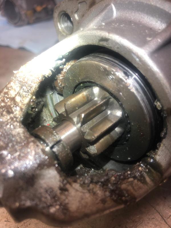

Hello, my first time on forum, sure could appreciate some experienced advice. After he passed one year ago, I recently purchased my Father in law's 1985 19' Bayliner Capri Cuddy with the four cylinder AQ125. Background: Don was meticulous with his boat, always garaged, maintained. Just before he passed, I know he had the boat serviced because he had a trip planned the next month. I took it to the lake for a shakedown cruise; it started immediately, always been cold-blooded so warmed it up and idled out slowly. It sounded great, idled for about five minutes in gear while checking oil pressure and temp. Everything good, so spent the next hour running at different speeds on step, then idled, always watching the gauges. Very happy with everything, I was on step at about 4000 rpm when my wife and I heard a high squeally sound. I throttled down into neutral and the engine died; Checked under the doghouse and noticed part of the 1" thick insulation blanket had come loose near the alternator. Reattached it and expected that was the trouble, though couldn't see any marks on the silver foil insulation.Wouldn't start, just one click each time I turned the key. Checked connections, then motored in with the kicker. At my shop, I tested the batteries, voltage at the solenoid, cleaned all connections, tried her with the muffs on, but the engine turned maybe half a turn, then click, each time I keyed it, then turned fractionally, all the while sounding scratchy. Then nothing but a click. Pulled the starter and found metal shavings at the flywheel.Pulled the spark plugs and tried to turn the main pulley by hand. Won't budge. Tried with a deep socket and a short wrench (no cheater pipe), still would not budge. Hoping for some kind of miracle...? Any suggestions would help, I'm really bummed and I need a clear plan to move forward.
