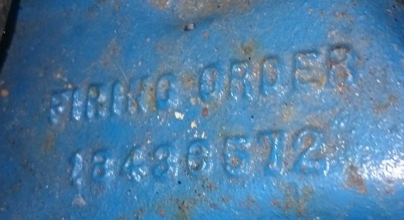

Now my 2nd issue - on BOTH motors the firing order says 1-8-4-3-6-5-7-2 however that firing order does not work on the counter clockwise motor.. The flywheel (as seen from rear looking fwd) rotates clockwise and the rotor moves counter clockwise -

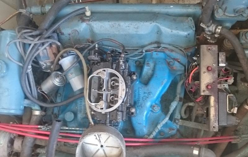

Here is a pic of the intake of the stbd motor (using reverse firing order seems to work much better):
Could using the wrong manifold cause these issues? Stalling / hunting at idle? When I give it throttle is has a smooth sound and seems very powerful.

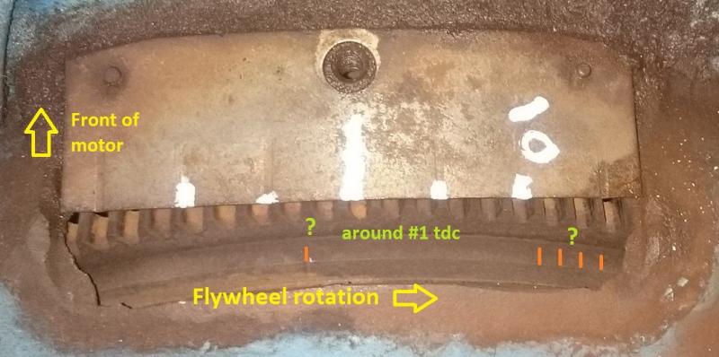

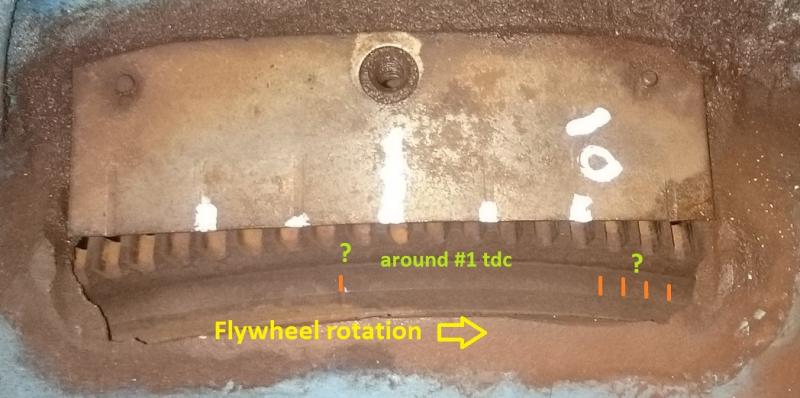

Here are the confusing timing marks on the flywheel:
Can anyone shed some light? The stbd carb went thru the ultra sonic cleaner, blew out - installed a kit.. and on the starboard motor it still struggled to idle.. hunted a little here and there (vac ports plugged).. When I put it on the port motor it ran MUCH better.. the plugs are burning a tan and for the life of me struggling to figure out what the issue is -
Im wondering if someone didnt erroneously install a regular rotation intake manifold on the counter rotation stbd engine and if it wd cause issues?

Theoretically (and only if these marks are correct), the single notch (when aligned with the zero) will indicate #1 TDC.
However, keep in mind that #1 TDC comes around twice.
When setting up your spark plug cables, you will want to stop the crankshaft @ #1 TDC on the C/S only.
Yes..... that would be correct.

For a REV RH Rotation Engine, you will still begin your firing order with #1, and then you will follow that with #2, #7, #5 etc.
Do not forget the importance of obtaining the correct Progressive and Total Advance for the Marine Engine.
I'm not a Chrysler Marine Engine expert, but I highly doubt that there is a difference between a LH and a RH rotation engine intake manifold!

Anyway - Ill report back later. Just odd why they would stamp the wrong firing order on the intake (unless this is intentionally done so they wouldn't have to make more castings/save cost)
Correct!
These engines originated in the automobile world, so there is no need for a REV firing order to be cast into the manifold.

Its like living it all over again!! Took me a day to figure out the intake marks are standard rotation only, no such thing as a counter rotation intake.. both dist run in same direction. Only mechanical difference is crank (oil grooves on journal), cam gear/lobes, and starter
Your timing assumptions are right on 5*, 10*, 15* you see why I recommended the yellow marks.

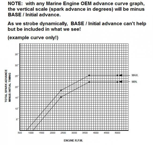

I fully agree. This can be done to most any old school mechanically advancing ignition system. New shaft bushings, adjusted flyweight system and flyweight return springs, and so on.
However, there is an issue that we may not have considered.
At the risk of being redundant, and as I said earlier, no one to date has been able to find a Chrysler Marine Corp ignition advance curve graph for any Chrysler Gasoline Marine engine.
We can find what Chrysler suggests for BASE advance..... but we find ZERO showing the Progressive and TA.
Without this curve graph, a shop who owns and operates an Old School Sun, Allen or King ignition distributor machine will not have the info needed to bring the curve back to within Marine Engine specs.
Secondly, most of the shops who are equipped with a distributor machine are automotive shops.
Automotive techs and Automotive enthusiasts tend to know much more about the automotive ignition advance curves than that of the Marine Engine advance curves.
The Auto curve may be more aggressive.
The Auto TA may also be higher!
These engines do not undergo the same extreme and constant loads, and if we put these specs into a Marine Engine scenario, we may have trouble!!!!!!
Also, if using BASE advance numbers alone, keep in mind that any change to BASE is an Equal change to the Progressive and TA.
Example:
If we adjust BASE to 5* BTDC, our TA will be XX* BTDC.
If we change the BASE from 5* to 10*, our TA will now be XX + 5* BTDC.
A 5* shift in TA can make the difference between NO Detonation and Detonation.
This would be Ignition Induced Marine Load Detonation, and can be very destructive.
Point being..... I would strongly suggest that we DO NOT haphazardly set up ignition advance without the aid of a proper curve graph for a particular Marine Engine!
Somewhere out there, there has to be something that was provided by Chrysler Marine........ we just simply can't find it!
If a Chrysler Marine Corp engine ignition curve graph is to be found, it will look similar to this GM curve.
TWO THINGS STRIKE ME AS ODD IN THIS CURVE
1 THE TOTAL ADVANCE IS ONLY 25*
2 ITS NOT ALL IN UNTIL 3700 RPM!!?
-tony

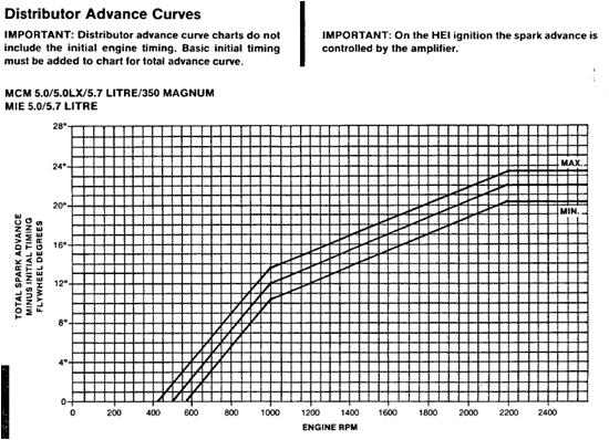

Tony - it seems the graph is in fact all in by 3500/3700.. Also - when using old 60s 70s timing, drop a few degrees off to be on the safe side, newer fuels take a little longer to burn anyway so even sticking at stock base will put u in a safe margin. #2 - 25 max is a safe enough margin for anyone, most marine engines have a cool suppl of water unlike a radiator - further decreasing the chances of pre-ignition imo-
The fact that curves arent available doesnt seem too much of an issue really, a v8 will run like most v8's - 28 degrees max and base of 5-8 and you will be doing causal boating for decades.
UNDERSTOOD! SO LETS GET TOGETHER AND FIGURE THIS THING OUT.
Be my guest!
When /if you do find an OEM Chrysler Marine Corp ignition advance curve for the OP's engine, please let us know!
IVE BEEN READING FOR 5 YEARS ABOUT YOU JUMPING UP AND DOWN ABOUT CHRYSLER MARINE TIMING. IT MUST BE OUT THERE SOMEWHERE?!!?
I do not recall jumping up and down regarding this.
However, due to the importance of this, I have posted to this effect more than several times.
RIGHT NOW YOU MUST USE AN OPERATIONAL OEM DISTRIBUTOR FROM A MOTOR AND FIND THE TOTAL ADAVNCE (MECHANICALLY LIMITED EASILY FOUND WITH THE RIGHT EQUIPMENT) THEN MAKE YOU BEST EFFORT TO MATCH THE REQUIRED TA RPM.
No disagreement there.
With a Sun, Allen or King machine, the operator would be able to see the existing curve, and would be able to plot it out.
However, if the existing curve is incorrect (due to old age and advancing system wear), that would render the info rather useless...... yes/no?
ALL THIS HAVING BEEN SAID YOUR WAY BETTER OFF REBUILDING WITH SOMEONE THAT KNOWS MARINE CURVES
Again, no disagreement...... but where is the OEM curve that this person would be using?????
AND HAS A DUAL DIST MACHINE
I guess that I'm not familiar with a Dual Dist Machine.
Would you please explain?
Look more closely at the verbiage to the left side of the vertical scale.......
Most all curve graphs are minus BASE advance. When BASE is added, you will see the correct TA.
Look more closely at my comment just above the image that I posted.
This is an example ONLY of a Marine Engine ignition advance curve....... it is NOT a curve for the OP's Chrysler Marine engine !!!!!!!
[FONT=Tahoma, Calibri, Verdana, Geneva, sans-serif][/FONT]
I must ask..... What graph?
The curve graph that I posted was to be an example ONLY as to show us what we would be looking for in a Chrysler Marine ignition curve graph!
Remember, a lazy ignition advance makes for a lazy LPCP.
A lazy LPCP makes for less torque.
Our concern would be Detonation..... not Pre-ignition!
Then again, I must ask....... how does a Chrysler Marine engine owner maximize his engine's performance?
You must associate a Total Advance with an RPM. Otherwise, TA numbers are meaningless!
Here is another example ONLY of a Marine Engine ignition advance curve.
NOTE: this is an example ONLY.... repeat..... this is an example ONLY.
It is not a correct ignition advance curve for the Chrysler Marine engine.
I am posting this image as to show us an example ONLY of what we would hope to find IF Chrysler Marine has made such a graph available.
NOTE: the line graph advance degree values are minus the BASE or Initial advance value.
NOTE: when strobing the timing marks dynamically, the BASE/Initial degree value can't help but to be included in what we see.
