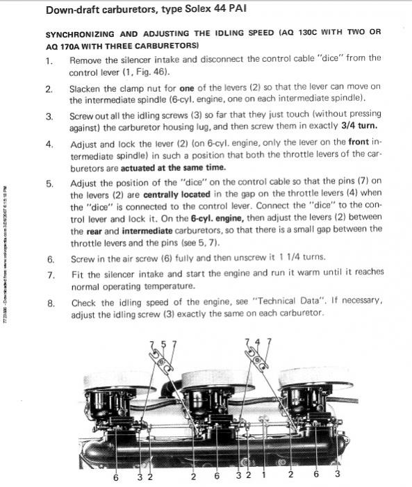

I tuned my carbs(aq130c) last year, but I forgot how and where i looked it up. I just forgot how to adjust the screws. I reset the screws last year to reset my idle and so on, but I for got where to which screw does what and where to start from. help is appreciated. thanks
Attached is a pic of the page in the V/P Operator's Manual. I'd suggest going to the Volvo Penta website and downloading the manual for future reference.

I have the manual, but it does not have what Im looking for as far as tuning the carbs. I saw somewhere in a post on where the preset the screws and tune from there, but I think I found it on the solex manual. and thanks el pescador, Ill keep that in mind.
