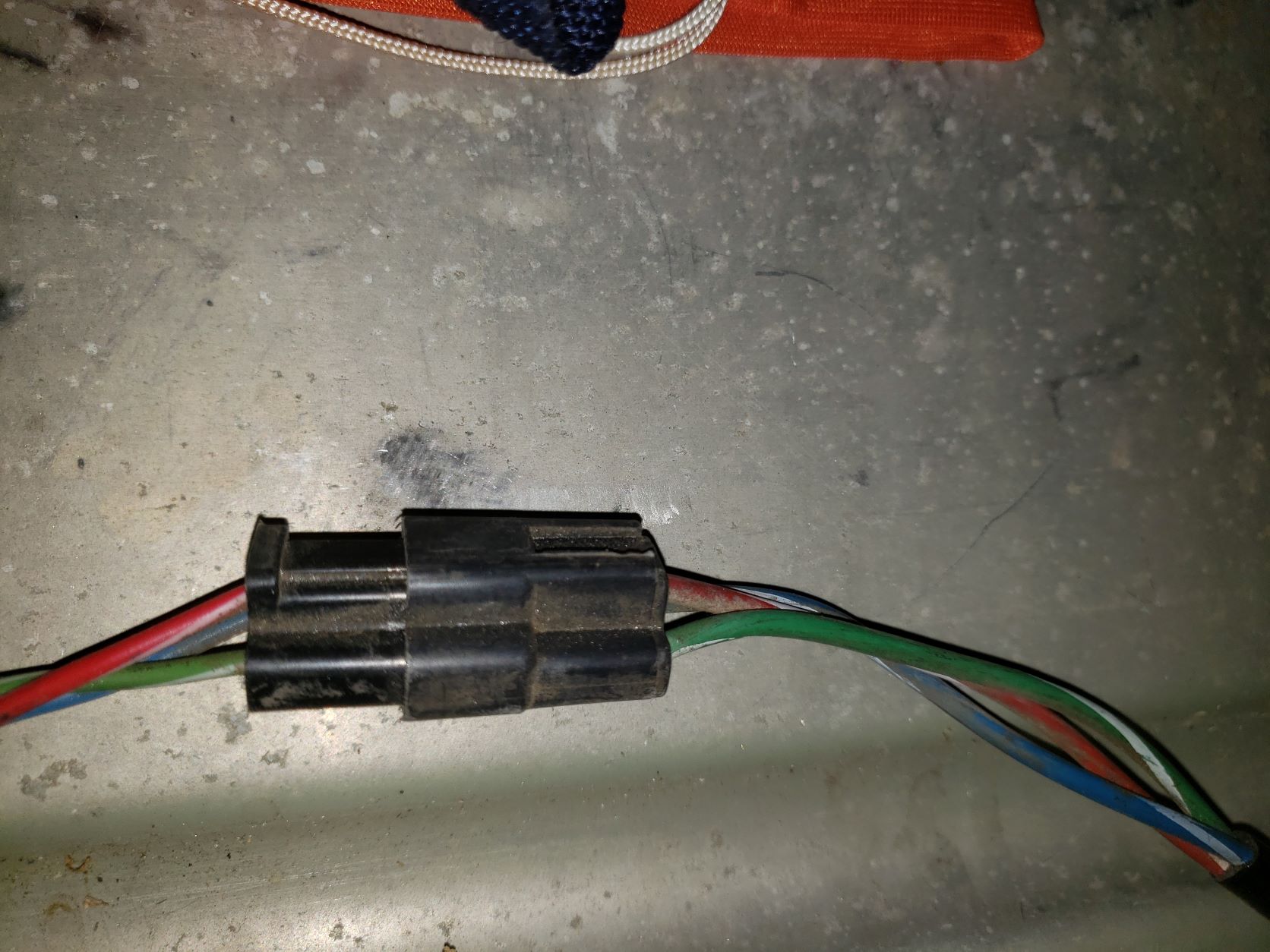

There is a wiring harness coming from the bottom of the remote control handle that has 3 wires going in and out of a connector. Wires are red/white, blue/white and green/white, picture attached. I presume these are the trim control wires, correct? Can I just jump the red wire to the green or blue wire to test the trim down or up respectively?

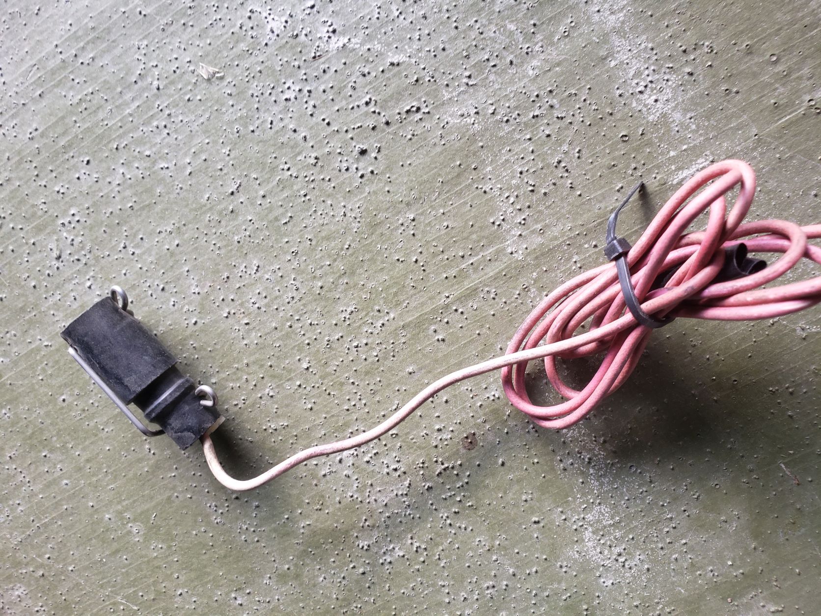

Also I attached a pic of a red wire that plugs into the back of the remote control. It is not hooked up to anything presently. Is this wire for a tach or something else?

The red wire tests positive for 12V but connecting it to the blue or green terminal does not run the T/T motor so the problem is not in the switch. What else could be the culprit? Can the solenoids pass all the continuity tests the manual describes but still be bad? When I got the motor the tilt/trim worked fine but then stopped working some time ago. This has not been a huge problem because I'm running a jet pump on it so I don't need to use the tilt/trim frequently I am concerned I may want to raise the motor when I am on the river if the pump needs attention.

The motor operates with the red , blue and green wires.----On that black plug in.-------The other wires are for an optional trim gauge perhaps.------Do not hook up any wires with the ---" lets see what happens "---- approach.----Smoke gets expensive.

I installed a new switch and it still did not work! After more investigation it turns out the problem was a bad three-way connector located near the remote control. The faulty connector was intermittent in nature making for a puzzling diagnosis but the connector is in the garbage (soldered the wires together) and the tilt and trim works perfectly with the new switch!
