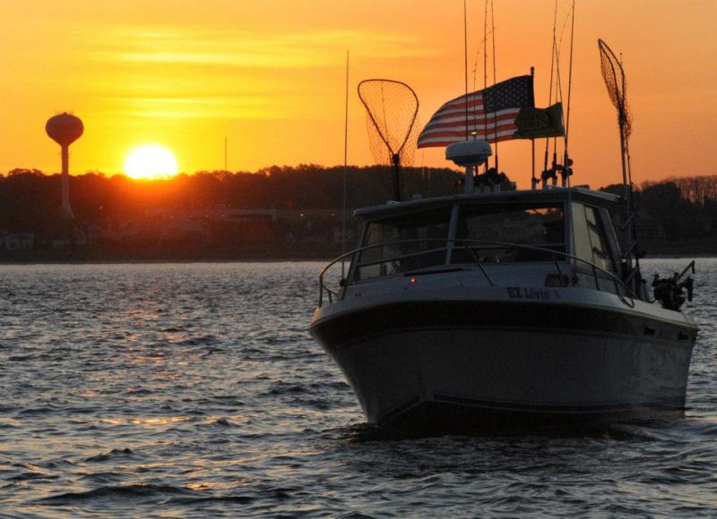

Hello, I have the exact same hull (1985) but mine is a 250 Brave. I'm not sure why yours is called a Sportfish, I thought that model name was for the 28 footers? And yes they like their fuel, I'm actually surprised you only used 12 gallons on the trip you described.I installed a kicker to help with the fuel usage while trolling.Be extra careful when running in following seas it can pitch you sideways in a heartbeat. http://www.ezlivincharters.com Michigander
