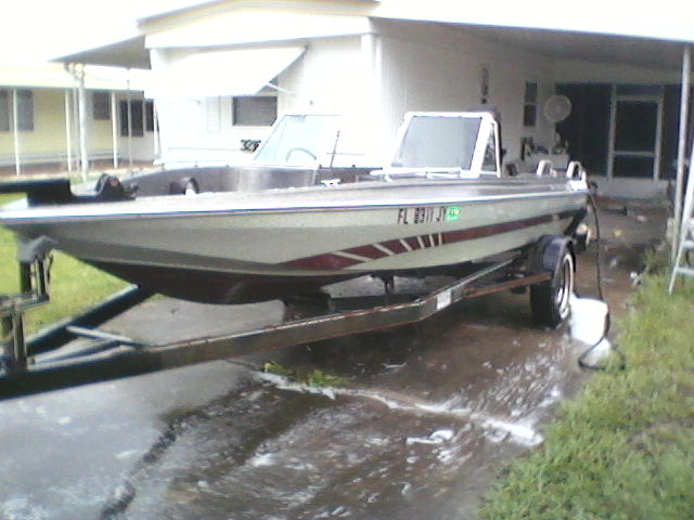

Newbee Hi Got and 1983 mercury 115 inline need to replace triger I alread got flywheel and stater off What is my next step / how to remove triger thanks got boat from boat angle's for $235. been sitting for 8 year replaced some floor and installed new carpet got alother things orking but no spark replace stator and rec/ get get spark thru,switchout
want to go fishing Charlie<br>
