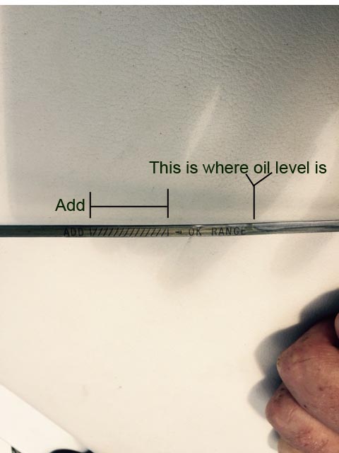

oil1.jpg Is the oil on the dipstick to high from a cold engine? Its about an inch higher than the ok range. The marine chap that serviced it said he took out 250ml yesterday to get it back on the mark but mentioned something about taking into account the oil filter draining back into the engine. All i know is that ive got loss of oil pressure on the engine and loud knocking noise now after only 2 hours of running it from a service.

Running temp was normal but had noticed a loss in performance since the service. 3 weeks ago it was taking on water from the y part of the exhaust which resulted in new exhaust, starter motor, trim pump solanoids etc. The water was about 4 inches deep in the boat before it was pumped out by the marina. All the work was done and then the service before it went back in.
