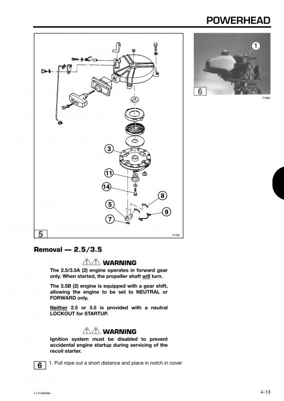

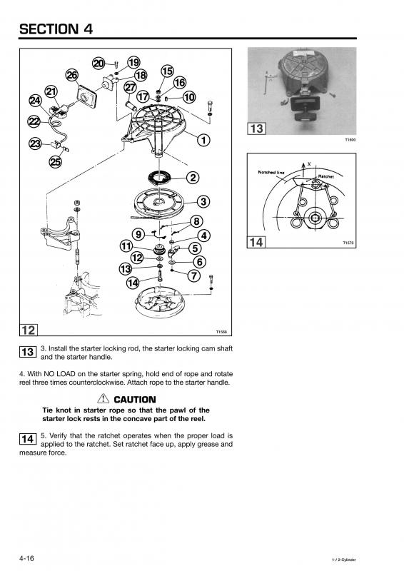

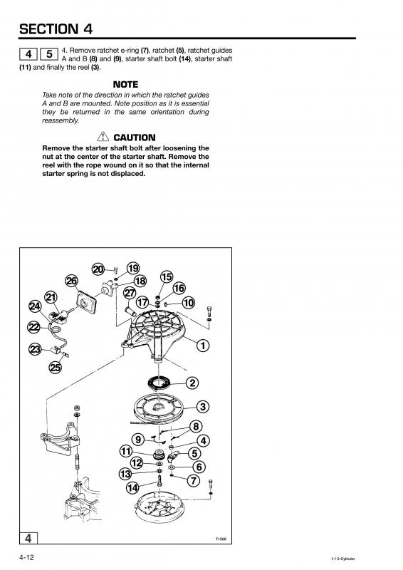

I am uploading a few pages from the Factory service manual that may help:
Thank you very much for the diagrams. It turned out to be either the rope I reinstalled initially was slightly too big and binding up, or, more likely, the "ratchet guide" may have been slightly bent and or not fitting very well in the grove. I flattened it in a vice and all is working.
