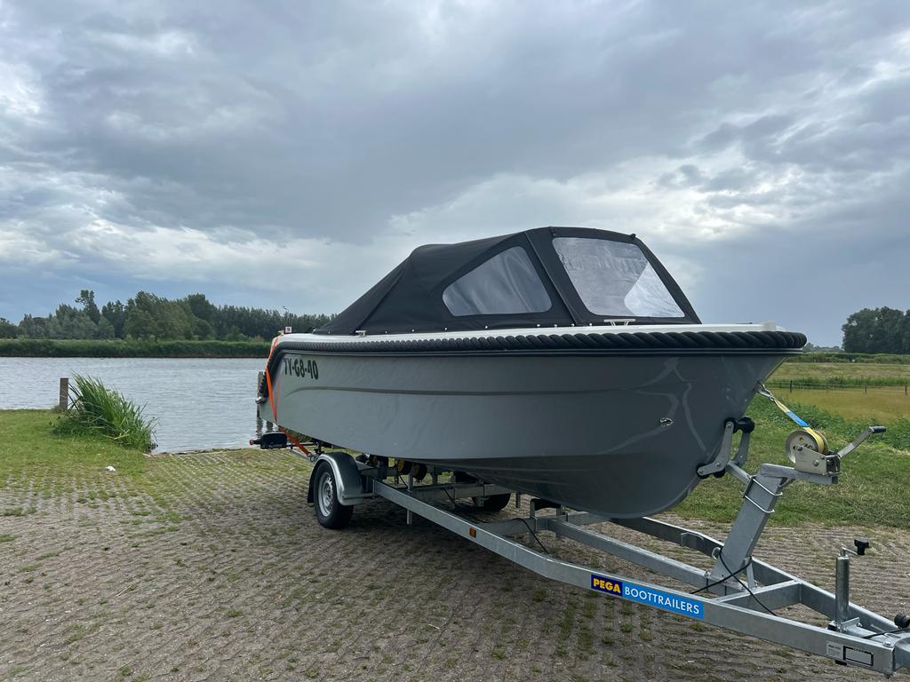

Hi All,
New to the forum and Tohatsu outboards.
I just switched over from a Yamaha Centre console to a Tohatsu Tender powered by a brand new Tohatsu MFS 60. The boat was idled and driven on low rpms per the manual. The boat has a max of 1hr of use and I could not get it above 4000 rpm at WOT to get it to plane just to see what it could do speed wise. The tender weighs a max of 480 kg and is 5.5 m long. It’s got a 3 prop blade that came with the engine and I have trimmed it all the way down to get it to plane. The manual states that full power is available after 10hrs of use so am I to presume that after 10 hrs the electronics on the outboard with get it unrestricted so I could go higher than 4000 rpm? Thank you
