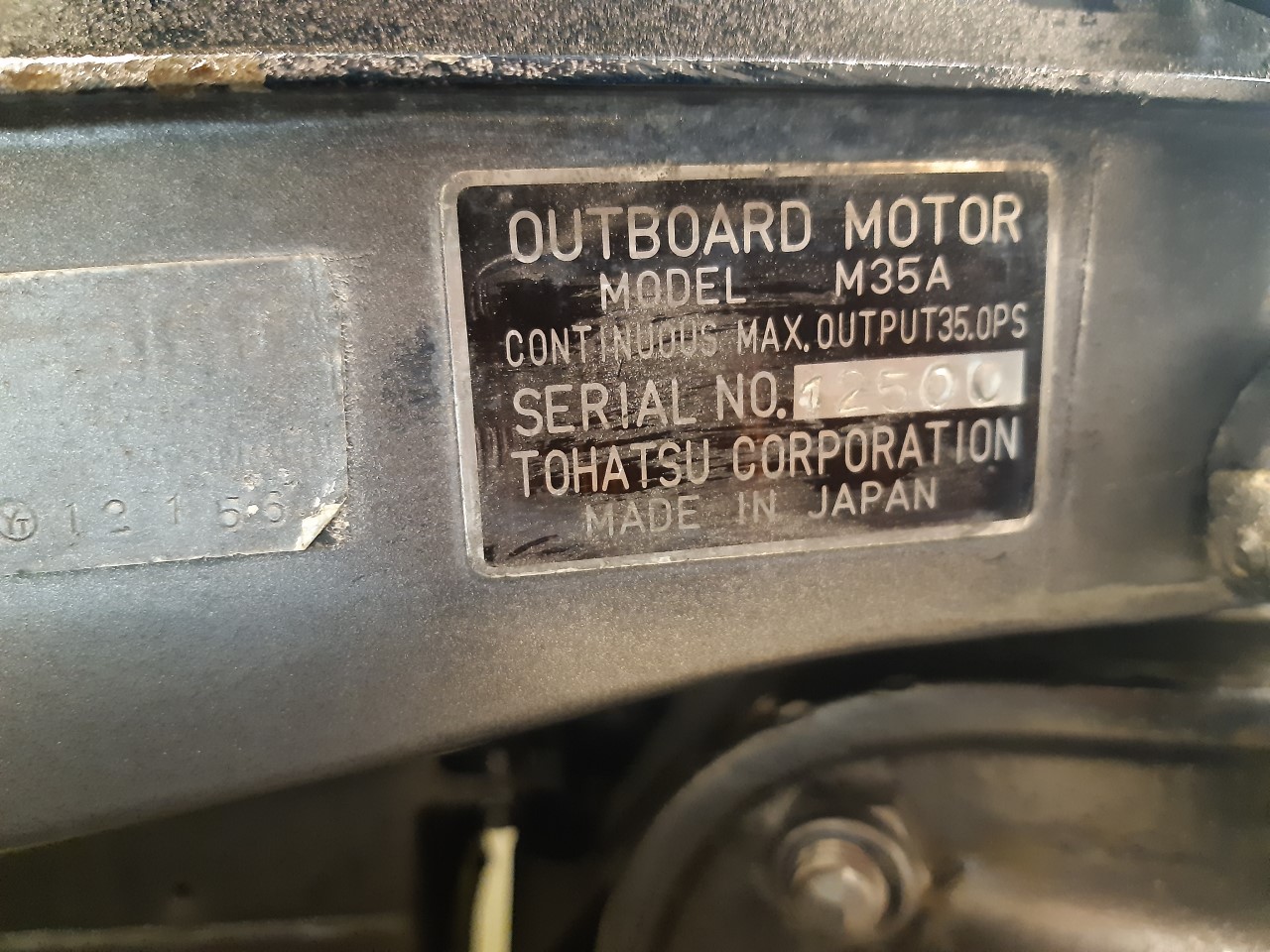

Here's the engineplate I found on the engine:
That motor may be from the 1970's. Good luck finding parts. It is possible that the water pump is similar on some later models, YMMV.

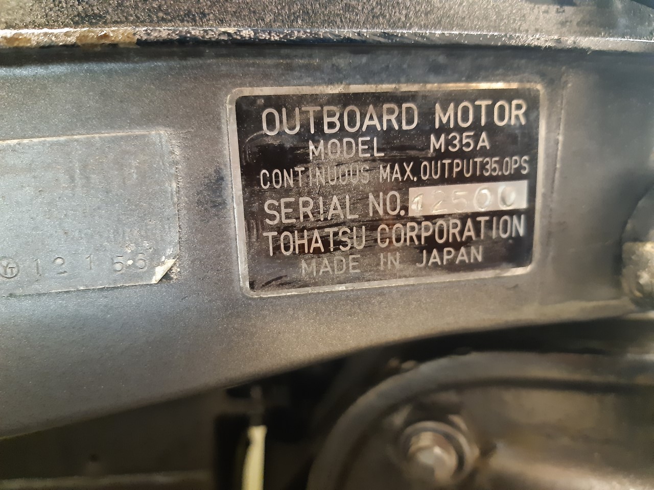

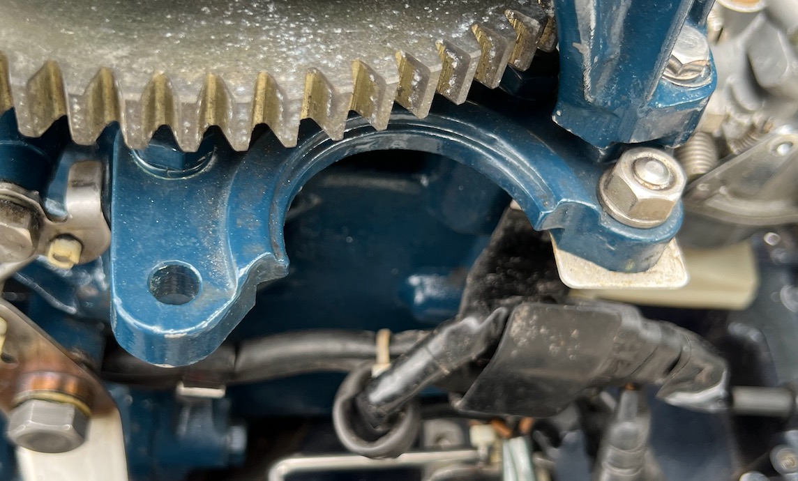

Hi, looks exactly as mine. I try to find some info about retrofitting a starter engine on this. There is clearly a place for one, but does anybody have a spare part number for this item? What about the manual, did anyone get hold of that?
Regards
Marko /Finland

Found all info (and also all parts needed second hand, locally), local rep was very kind to provide needed info. Model mostly same as M40C, which was continued until 2012, many parts same for Suzuki also. Files to big to upload here. Contact me if you need the manual, parts lists for M35A or M40C.
