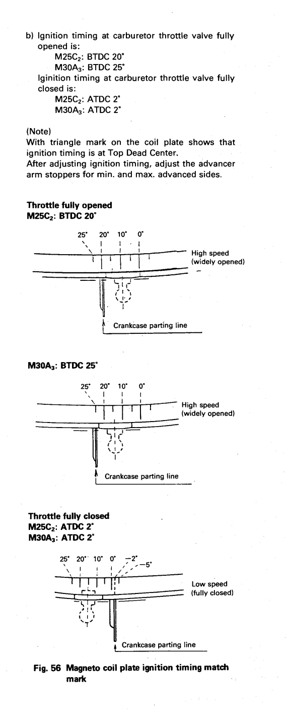

Hello everyone,
I want to give my outboard a quick once over for the starting season and wanted to check if timing advance/retard is still within spec, however I have a hard time finding specs.
Can anyone tell me:
Can anyone tell me:
- Correct length for the timing and throttle linkages
- Denomination of the index marks on the timing plate
- Degrees at idle
- Degrees at WOT
