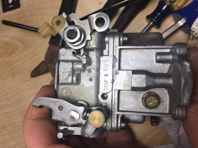

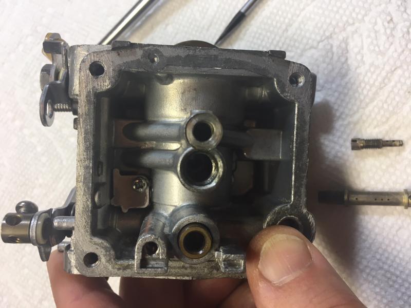

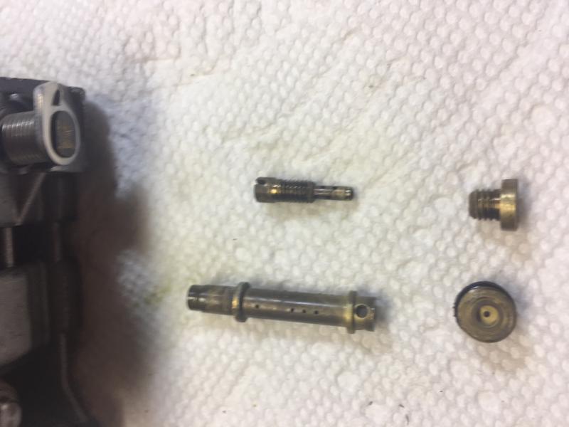

Anyway, here are a few pics. Mine seems to have a brass screw-plug.

Yep. Yours looks fine, with the brass plug. The jets and emulsion tube "nozzle" look like a lot of water has been in the fuel, possibly dissolved in E10 gas. Hopefully after a thorough cleaning, you will be OK. After the soak, and a round in the ultrasound, blast out each and every passage (including those small holes in the nozzle) with a whole can of spray carb cleaner.

Never ever push any kind of wire anywhere in a carb. It causes scratches, which causes weird mixtures at some velocities. Assuming the carb is the issue, new ones are available. I'm a dealer. There are two different carbs; I assume you have a tiller-operated motor. You are referring to the casting number, which is not the part number.
