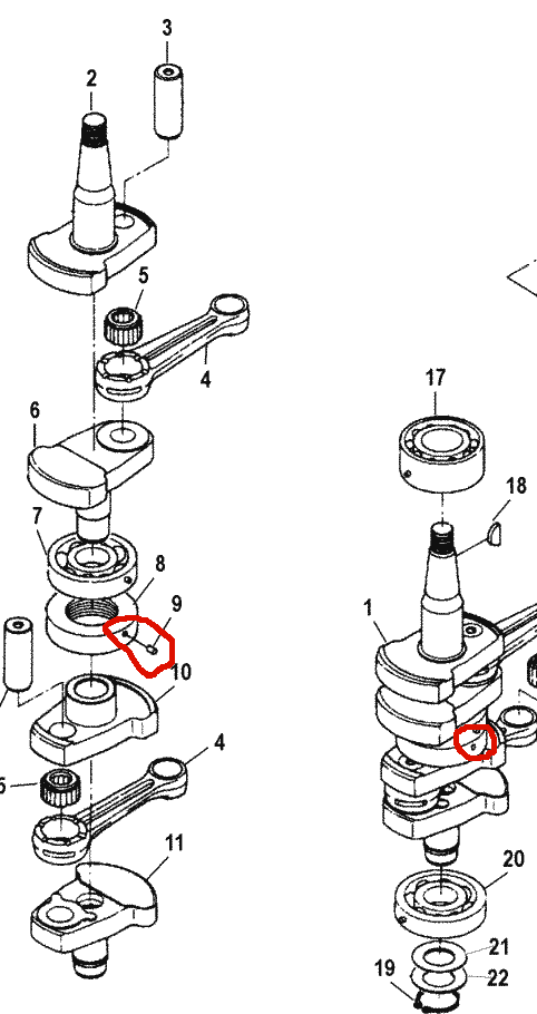

I'm looking at reassembly and putting the crankshaft back into the crankcase. The manual says "All main bearing knocks (21) are seated against thecrankcase mating flange of the cylinder block for properalignment with the crankcase." I can see the knocks although it's not a term I'm familiar with (Prior to this I wouldn't have wanted a knock in a bearing) and I can align them with the notches in the crankcase. However there is also a pin in the seal that is in the centre of the crankshaft and there is no notch for that. It isn't mentioned in the manual. There are three potential holes that the pin could fit in (2 in the cylinder block and one in the crank cover) . My question is which is the correct hole to use. I am fairly sure I know which was used before as there are some witness marks from the knurling on the seal but that looks to me as though one cylinder would have a greater crankcase volume than the other. I don't know whether this has been taken to bits before so I'd like to confirm the correct position for the pin.
I'm attaching a picture showing the pin I'm talking about. Where does it fit?
