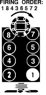

My question is this, looking at my engine from the prop side (rear) looking forward towards the pulleys, #1 should be all the way forward on my left side correct?
Question two, the plug that I was connected to when i could see marks was on the right side of the engine. What does that mean? Am I confused about #1 plug? Did the balancer slip? Is the distributor not set in correctly?

the attachment is from the 2008 classic owner's guide. The GM based "V" engines have had the same cylinder numbering scheme since before I was born. Attachment should answer number 1.
Number two depends upon which one on the RHS you were using as well as how you made this determination.
When in doubt, the best method to select a cylinder's spark plug lead is from the spark plug, NOT the distributor cap.
Balancers "spinning" do happen much very infrequent on most pleasure boats.
The definative test is to get the #1 piston at TDC. Like you say, forward left side. You can get a special tool for this, or carefully use a welding rod to determine TDC thru the spark plug hole.

Try this.

# 1 is going to be the same cylinder for either LH (standard) rotation, or RH (reverse) rotation SBC engines.
The direction in which you strobe the marks will depend on which hand the engine is.
Yes, the image posted is correct for a LH (standard) rotation engine.
(rotation is always determined as if viewing the flywheel end)
