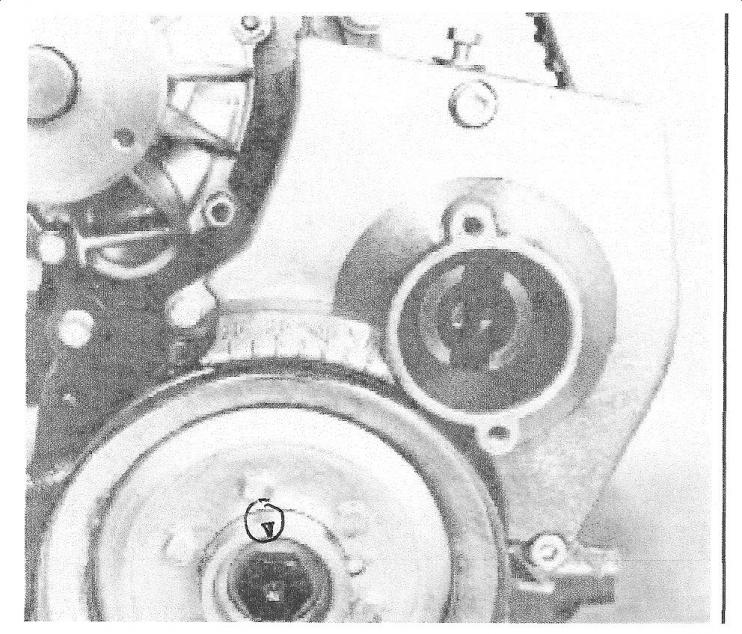

Rick, I have attached a picture of the problem, The only mark is on the crankshaft pulley is the notch/ groove which I have circled. I cannot find a mark on the outer rim to time from.
Should there be a mark on the outer rim or is there a special tool to create the mark.
At this moment I am totally confused
Regards and thanks for your patience so far
Nick
There will be a small indent or chip out of the v-belt pulley, up towards the top of the v-belt when in the groove. That's TDC.
Correct.
The outer area of the pulley belt groove will be either stamped or notched. I'm thinking that it will be notched.
When this notch aligns with the ZERO marking on the aluminum cover, this is your #1 cylinder theoretical TDC.
As you strobe these marks, any increase in RPM will cause the "notch" to appear closer towards Starboard.
At idle RPM, this will be your BASE or Initial advance.
Don't confuse the two...... you need to time this engine for BASE advance......., and then look at the progressive and TA.
Your TA is what can make power and torque, or it can cause engine damage..... (depending on if it's out of spec either way).
Nick
There should be a mark on the outer rim of the pulley. No wonder you don't see the strobe. your mark is for the pulley alignment on the crank shaft. I know, swedish engineering.
