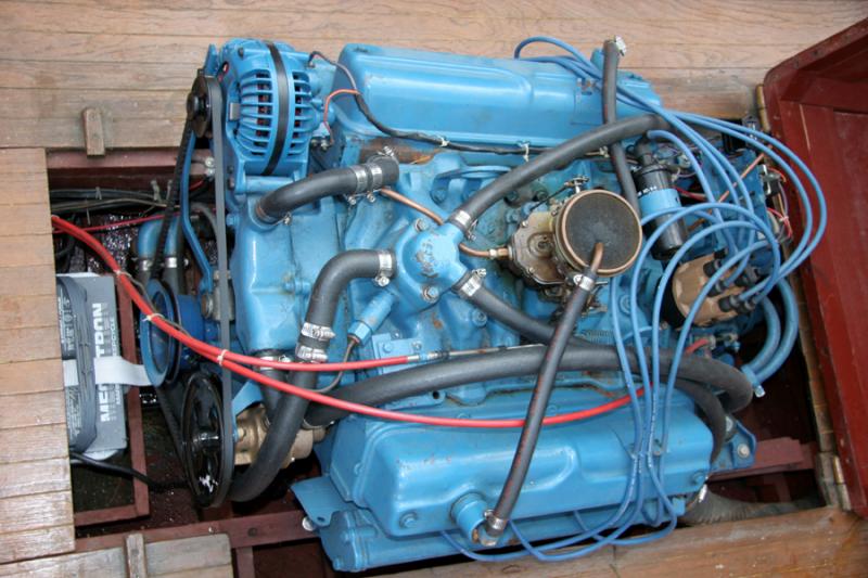

Here is a Standard LH rotation auto/marine engine as viewed from the flywheel end (of which is industry standard... exception being that of early Chris Craft).
This is typically seen being installed on the Port side!

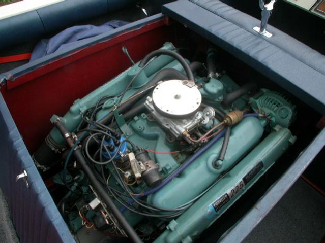

Your Stbd side RH REV Rotation engine is as shown here...
.......... which generally means that the firing order is also the reverse of the LH rotation engine, beginning with #1 cylinder.
For most REV RH Rotation Marine Engines, #1 cylinder remains the first on the firing order, followed by the last cylinder used for a Std LH Rotation Engine (unless an alternate firing order REV RH Rotation camshaft is used on these).

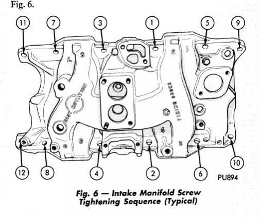

In that same pdf, page 26, fig. 6, clearly identifies the cylinder locations by numbering the intake manifold runners. And yes, some manifolds are really numbered. Check it out folks!
