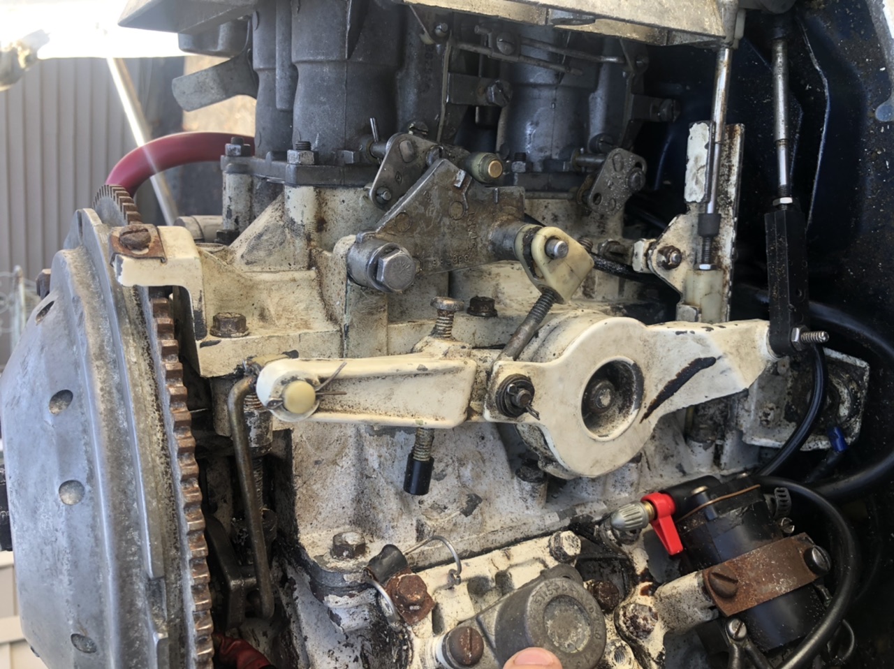

Well I just checked the timing on my johnson 140 and in forward idle it’s supposed to be 4-6 degrees “throttle pickup”. I was at 16!! It was warmed up and in a tub of water. When I moved the timer base rubber stop forward till it hit, I was getting 4 degrees. How do I adjust this so the timer base rubber stop is all the way forward without putting everything else out of whack? Is that even the right approach? I attached a pic for reference.
