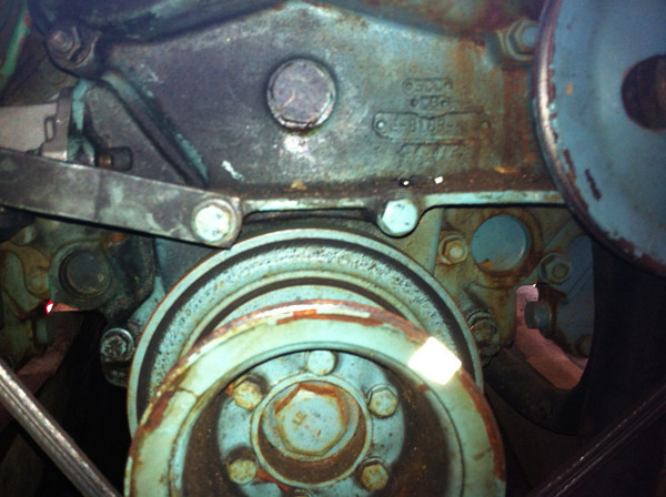

Hey guys thought I would start a new thread to tackle how to time this 1973 318. I found the rubber flap on the bell housing and seen the flywheel. However is there suppose to be stationary marks in there?
I also heard someone say something about the Harmonic Balancer. Where is that located?
Here is a picture of the front of the motor to show that i have no stationary numbers up there.
The pulley at the bottom of the image is your harmonic balancer. On some engines there is a timing tab above the balancer on the right. Your engine doesn't have one. Mine don't either.
You have to use the marks on the bellhousing. If you remove the rubber cover you should see an arrow or some pointer mark on the bellhousing. Use a flashlight to look for it. It can be dirty, rusty, and faded. Use some whiteout or a white paint marker to brighten it up.
There should also be a painted mark on the flywheel. It's either a dot or a triangle or a line. When you line up the flywheel mark and the bellhousing mark you're at Top Dead Center.

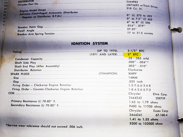

What more than this would you need? Factory Chrysler manual:

Great so will there be stationary numbers/degrees on the bell housing or flywheel in which I will know how far advanced it is when i get the RPM's up? OR how will I know what degrees It is firing without any stationary numbers?

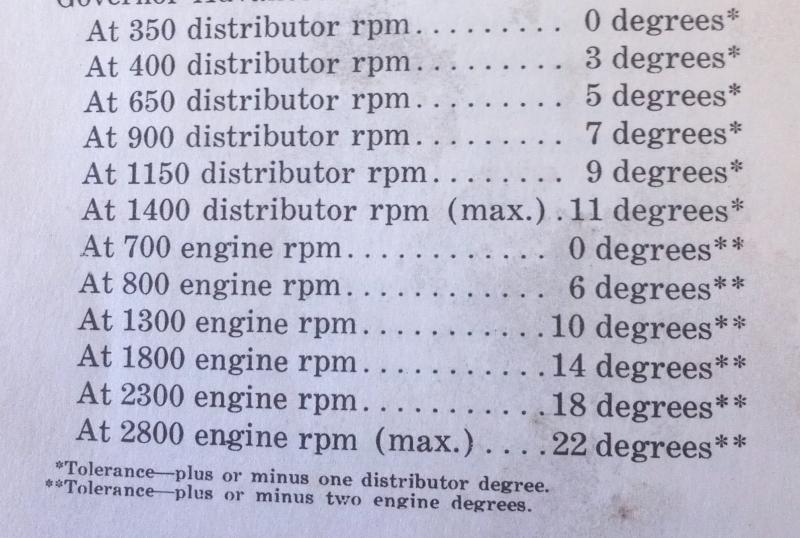

The numbers that will be more useful for setting timing, will be these.

Where did you find this, and what engine are these specs for? (the top hase been cut off!)
Are these for the 318 and 360 engines?????
I have never owned a small block, I have manuals for crown , ace, hemi, and RB Big blocks. I no longer have a hemi, but still have the manual.

I have never owned a small block, I have factory manuals for crown , ace, hemi, and RB Big blocks. I no longer have a hemi, but still have the manual.
Jfreeman, if I'm understanding Tahoerover, those numbers are NOT for the 318, so I'd NOT use them!
Dang it .... back to square one! :mad:
No, the bellhousing won't have stationary numbers. It will just tell you when you're at TDC. Therefore, you need to borrow/buy a timing light that has advance adjustment capability. For example, when you set the light for 5* BTDC you'll see the markings line up like you're at TDC. The adjustable light basically delays the xenon strobe to fire depending on what degree BTCD you set it to.

Thanks you. That is what I needed to know.
What does 5 degrees BTC mean?
So what does this mean? in correlation to the timing procedure? Is there where you start? Sorry for the lack of knowledge on this subject and thanks for your help.

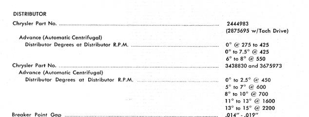

This is pretty much what everyone has come up with so far.
Without the progressive numbers, it's rather meaningless, IMO.

Try to make a curve out of these numbers, and note that these are distributor degrees, not crankshaft degrees.
I did this a while back in one of the 440 threads, and the numbers do not work out.

I just scrolled through the Factory 318/360 manual that Tahoerover posted a link to.
I could not find anything pertaining to ignition advance, other than a BASE of 2 and 5 degrees.
Chrysler Marine must make a huge assumption that nothing within their mechanical advancing system will change due to rust or corrosion, nor will it require varification in the future.

Why can't you make a curve?
You can make a curve from those numbers, but take a look at how it plots out!
I tried this in the "M440X timing" thread from November last year.
I'm fairly up to speed on Marine Ignition advance, and I can't make any sense of those numbers.
