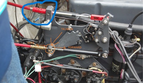

i need some help. i have a 1989 bayliner capri with a 2.3 omc cobra . on the throttle cable there is a red part on the cable that connects to a bracket, the red part keeps the cable from moving back and forth. i need one of those. does anyone know where i can get one

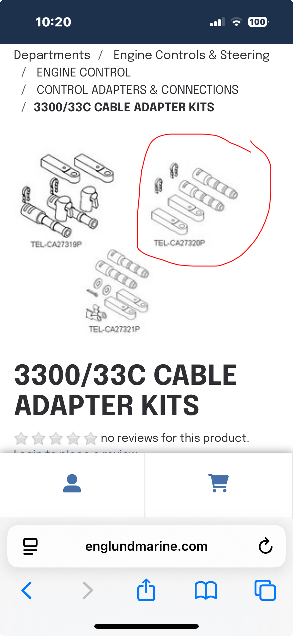

What did you order ? Did it work ?
I orderer the kit with the red adjusters, red clamp and hardware and everything worked great.
But with the offset of the throttle cable and bracket, the bracket originally pivoted horizontally well i made a bracket so and mounter the pivoting bracket vertically and it worked great
