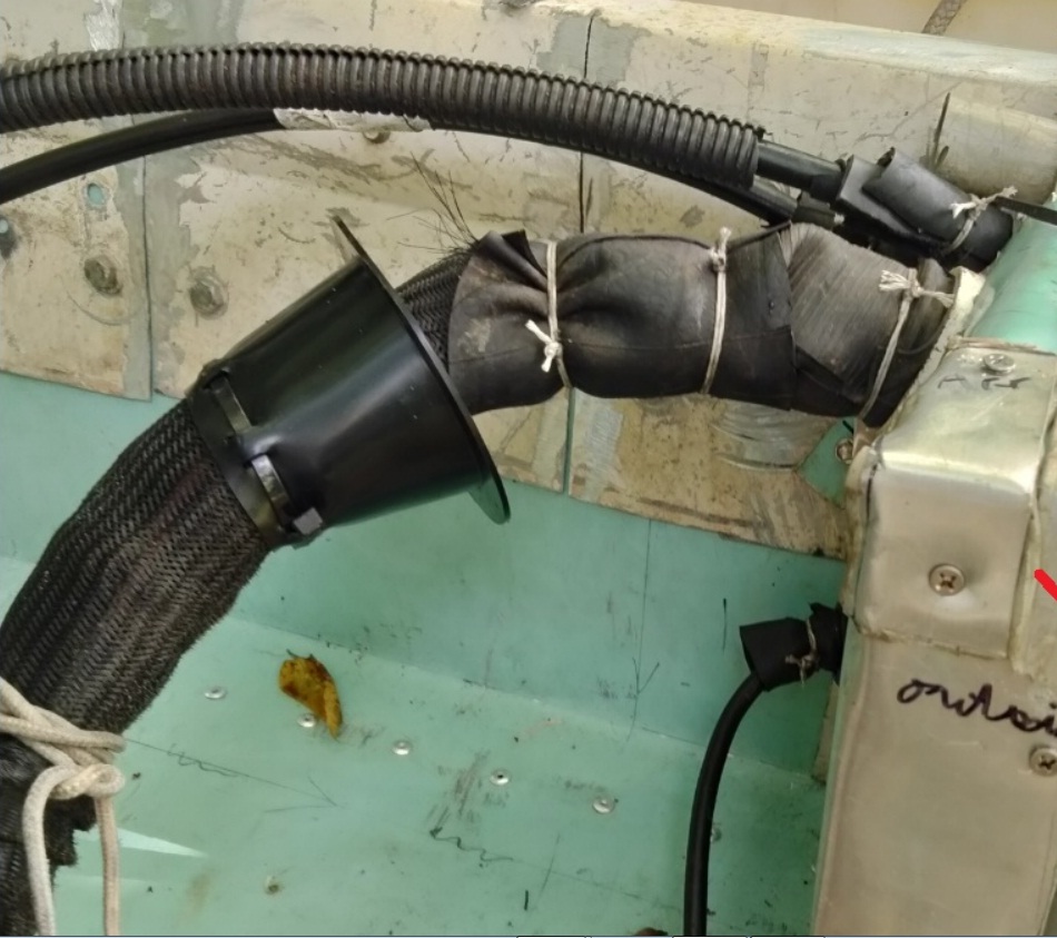

90% of control cables are straight except for exiting out the splashwell theres a 90* bent small service loop an straight into engines rig tube.
I’ve even relocated the fuel line to outside the main rig tube so there’s not a bunch of rigging stuff jammed into the main hole so the cables aren’t being constricted in main tube that enters the engine.

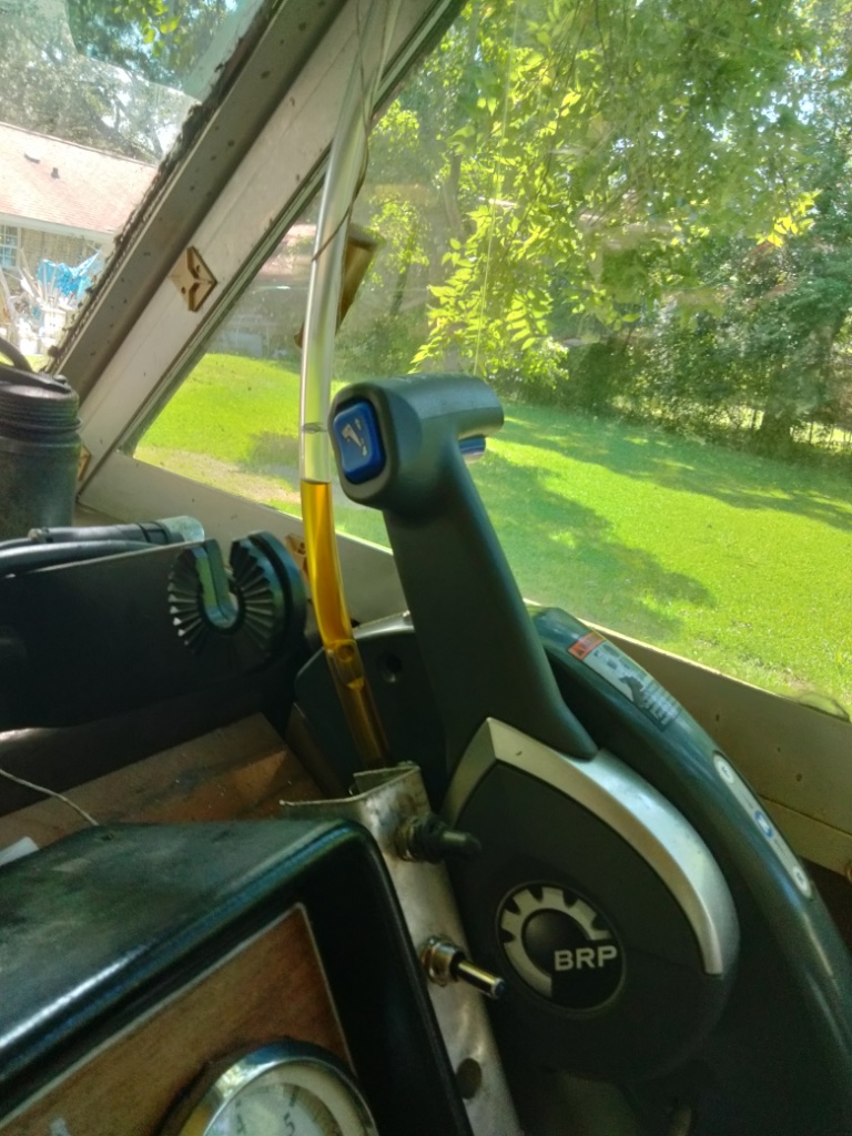

Here’s the lever w/ binnical throttle lever at WOT so I assume the cable is adjusted closely. Image

The cable which is newish felt kindof smooth when I was pushing an pulling during the oiling (all this done after completeing rigging) however the binnical which is almost new seams to have quit a bit of friction
Could I have to much constriction during the rigging?
90% of rigging is attached to gunnal w/ loose rubberized C/clamps only section that could be a bit constrictive is at the splashwell? I doubt the cable is falling apart inside.please advice

After adjustment binnical at WOT pushed lever to here returning to idel smallish gap image
my hand pushed it even further back increasing gap just a a tad more image
after this adjustment the throttle actuator lever may not be completely WOT bc this arm isn’t contacting the rigging standoff any more. Now maybe this arm isn’t designed to contact the standoff which makes sense bc metal to metal isn’t good. So maybe I have it adjusted closer than I think. I assume I can confirm WOT by observing the throttle plates?
