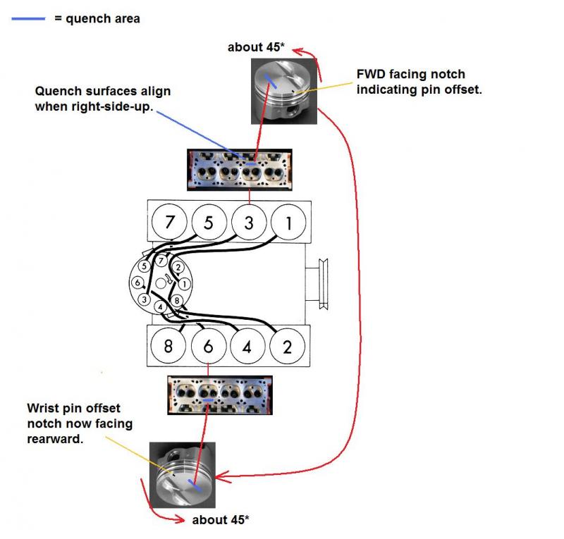

Here are a few images that I created some time back. Perhaps they will be useful..... perhaps not.
BTW...... if one of these is to be a RH REVERSE Rotation Engine...... watch the wrist pin offset and the crankshaft seals.
MM, I don't claim to know the Chrysler 5.9L engines. I am much more familiar with the GM SBC.
However, the two do share some similarities in that they both incorporate a "Wedge" style combustion chamber...... of which lends it'self to a Q/E if the build is done correctly.

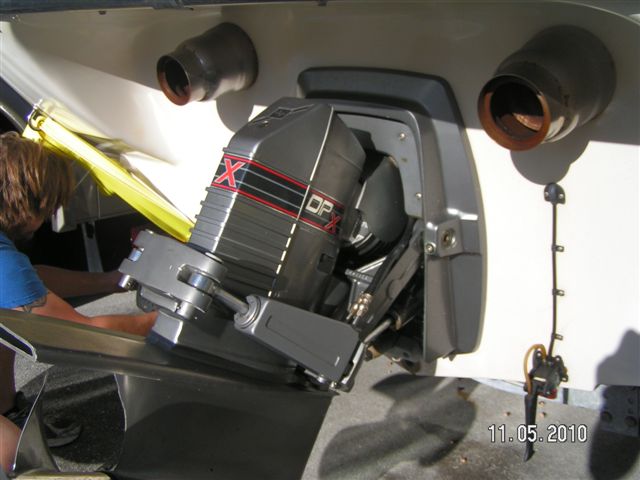

This is the drive I plan on eventually run
it is still based off the Aquamatic architecture
Yes..... these incorporate main suspension fork and pivot tube geometry. Much better than a Gimbal Suspension system and with far fewer issues.
