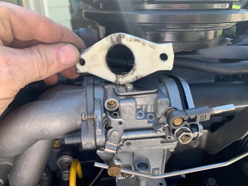

image1.jpgFound this sitting on top of the block rubbing on the belt. Looks like it goes on either side of the carb; maybe at the air intake(?) iDK
Started dinking with carb last fall and got busy. I just cleaned out the fuel line and carb and found this while I was testing out the engine.

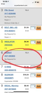

The gasket actually looks like a newer mercury 15hp 4 stroke gasket. Possibly 2013 and up
