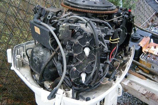

Did you disassemble the engine or use the squeeze in method? I didn't see how it could be squeezed being that mine is a bubble back, the room just was not there. Is yours a bubble back? See the bubble in the middle over the thermostat area:

Agreed, OMC didn't seem to put much thought into owner maintenance with this issue. Without a shop like environment to work in, pulling the power head was just too much of a job for me to tackle in my environment this time of year. To answer your question, NO, my motor is not a 'bubble back'. I hadn't noticed previously but the parts diagram here on site shows mine to be a 'bubble back' manifold. ?? I'm guessing it's the same reason a Ford truck I once owned had the previous years front end, it was made in the 1st half of the year. Those later in the year had the newer style. Maybe someone reading this thread can explain?? Racer? Joe? Kim? anyone?
The 1985 90hp did not have the tuned exhaust setup via the "bubble back" in 1985 or in any other year. That did not come into place until the following year when that 1986 model was upgraded to 110hp.... the 90hp of 1986 continued to have the standard flat back-plate exhaust setup.
Bubble back exhaust was first used on the 1973 135 hp models.-----Used on the higher rated V-4 blocks untill the last ones in 1998 I believe.-------They show it on all the crossflow V-4 models in the parts book just because they can !!-----Saves putting out more parts books !------On " looper " blocks the tuned exhaust was part of the block itself.
I see. Well that answers my next question as to the "why" they were bubbled outward like that .. a tuning feature. Thank you.
If you are working with a Crossflow head that has the larger exhaust housing, remove it.
Removal of the thermostat housing with the exhaust system in place is certainly doable, but getting the springs and thermostats to align without falling out on reinstallation is a bit of a chore without getting the larger exhaust manifold out of the way.
