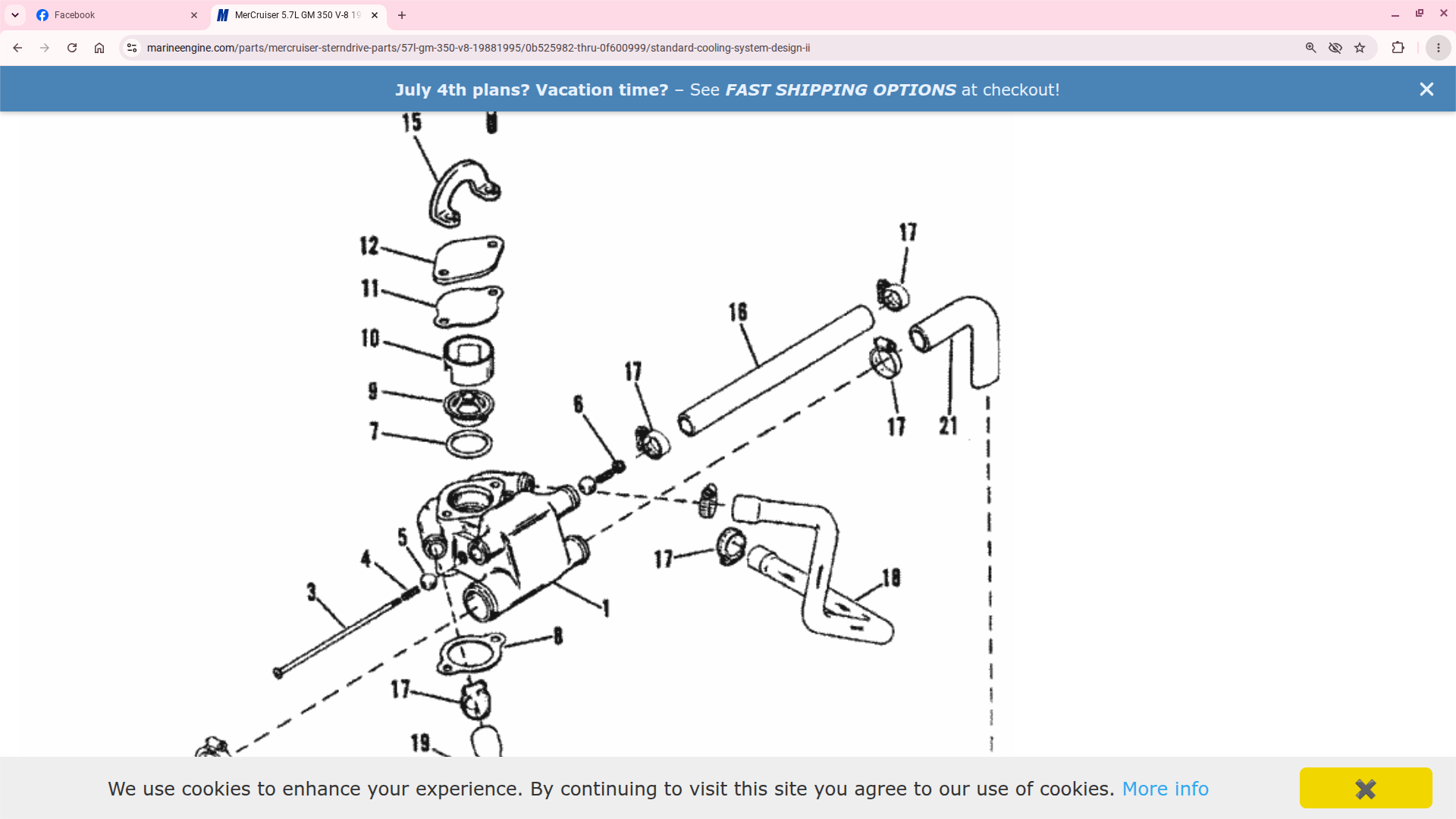

Hi. I have a 1988 5.7 Mercruiser, with an Alpha 1, Gen 1 outdrive. It has a standard cooling system, design 2. I went through the parts list, and ordered the following parts for it:
25-8M0204561 O ring
8M0109441 160 degree thermostat
23-8M0214947 thermostat sleeve
My problem is that none of the parts fit! They are all oversized by about 1/8-3/16" too big in diameter. Were there two different versions of the same thermostat housing made??
I've attached the parts breakdown shown here on Marine Engine.
Any help would be appreciated

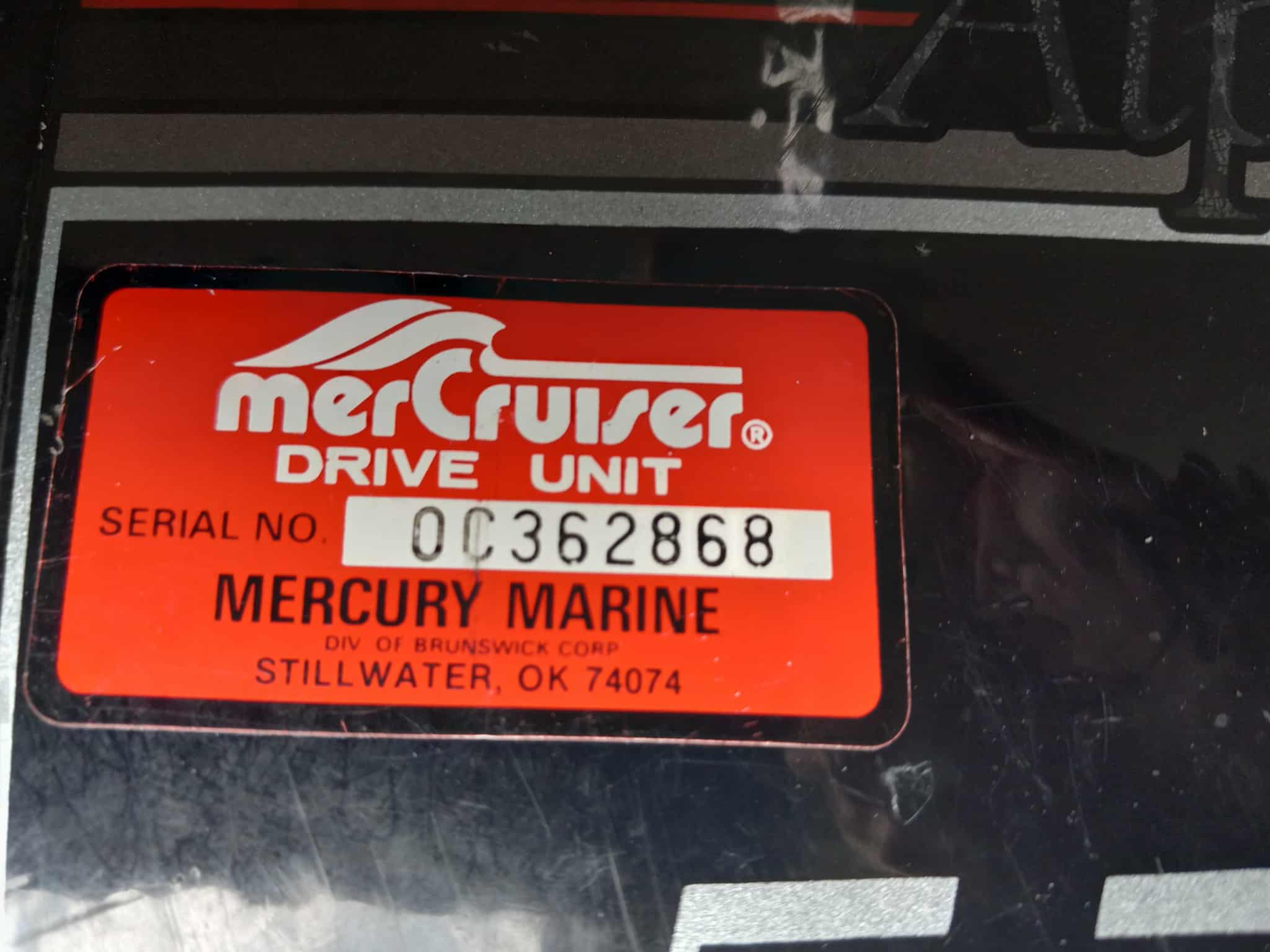

I don't have an engine serial number, all I have is the drive number. Which corresponds to the parts I looked up

The key to getting the correct parts is the engine serial number. The drive serial number realy won't help you narrow down the range of the engine choices, especially if its not the original drive.
That vintage engine, with standard (RWC) cooling should have a 140 deg t-stat.
My guess is that you looked up an engine that's newer than what you have.
There should be a serial number plate above and behind the starter, on the flywheel cover. If its tight getting to that area, a cell phone in camera mode may be helpful.

As far as part fitment goes, We are unable to see the condition of the housing. Is it full of rust scale? The cast iron could have corrosion swelling but again we cant see it. Can the side walls be scraped and material comes off?
Link for this web site for YOUR ENGINE 350 ci 260 HP1988-1995 SERIAL NUMBERS - GM-350-V8-19881995 (0b525982-thru-0f600999)
that's where I did get the part numbers from, and the parts don't fit! And no, I cleaned out the housing with sandpaper, until it was shiny steel. None of the parts I ordered came close to fitting. And I don't run in salt water, strictly in cold fresh water.
