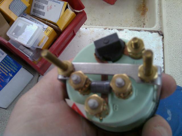

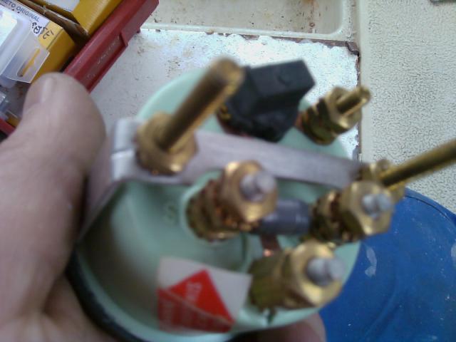

I have bougth a OMC temperature gauge. Just the gauge no device for the engine side. See enclosed pictures.
I havethe following question
1. What do I need on the engine side ?
2. How to connect (could there be a wiring diagram for this) ?
Engine
Johnon 150 Fastrike 1998 (J150GLECD)
I goes to ignition (power on )
G goes to ground
S goes to the sender as shown.
