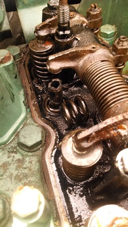

Today, I pulled my new starter out... it's busted. Whatever is holding the engine from rotating past a certain point it holding it REALLY well. I'm starting to suspect timing/valve issues.
It seems that something is out of place...
Maybe an injector tip stuck in a cylinder? You could check which cylinder is at TDC when it gets stuck (which 2 cylinders I guess) and might be able to pull the injectors to see if anything is obvious on those two. If it getting stuck with no cylinders at TDC (or very close) then you probably have an even more serious issue.

You dropped a valve into the cylinder, thats why its stuck. These motors are easy to fix, you need to pull the head and oil pan, and remove that cylinder liner and piston. Replace with new liner/piston kit, and also install new valve and spring. Make sure little valve retainers are on there tight, so it doesnt drop again.
