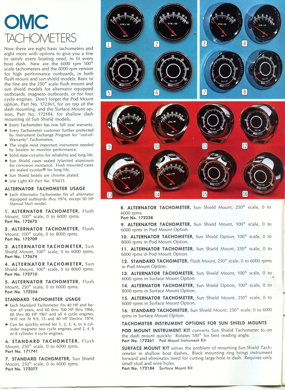

I Think what you have there is the "Standard Tach" # 6 & 7, which are appropriate for your 40hp.

When I enlarge the pic, I see the word "ALTERNATOR". The engine has a generator, no alternator. So this is not the right type of tach. And that was confirmed by a guy on the antique outboard motor club forum... So thanks for your interest!
