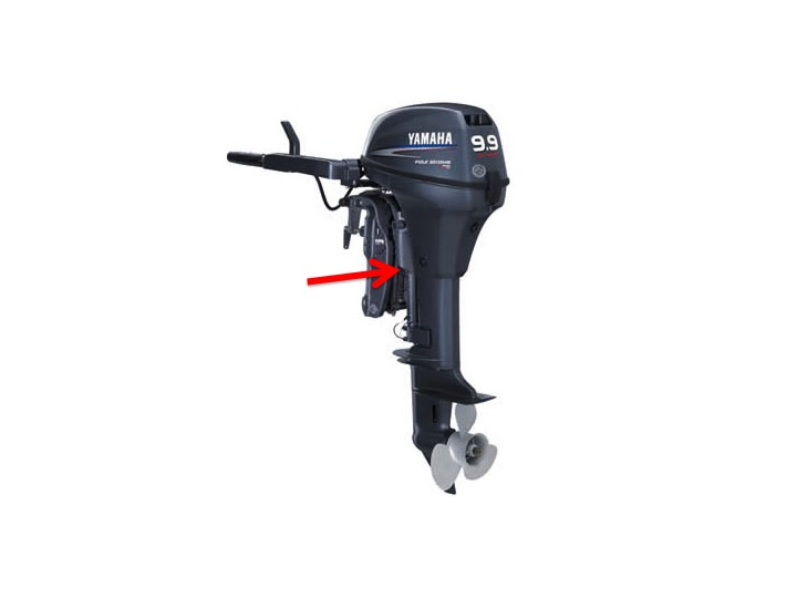

I will be going down later today to try to get a pic but for now here is a stock photo showing the area I am talking about.

This doesn't sound right to me. I wouldn't want salt water (or even fresh) constantly shooting towards the pivot housing. There is normally a small amount of water that comes out an exhaust outlet above the water line, but it normally faces backwards and isn't very much at all with the bulk going out through the prop. It is possible that the muffler isn't sealed properly to the powerhead but I'm not familiar with this exact outboard and it seems very new to be having that type of problem.
Stuart
I spoke to the dealer yesterday morning.
Yes, the water coming out of these two forward facing ports is overflow due to the water pump pumping more water than can be passed through the cooling system.
It is also normal to see some spitting out of the port at the rear of the OB just under the cowling clamp as you mentioned. This is an exhaust relief valve and since it is a wet exhaust system, it may spit a bit.
He also confirmed that the tell tale water flow is after the cooling system so as long as that flow is strong everything is good.
I wasn't sure about that, just knew if it stopped there was a problem.

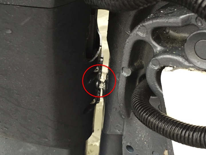

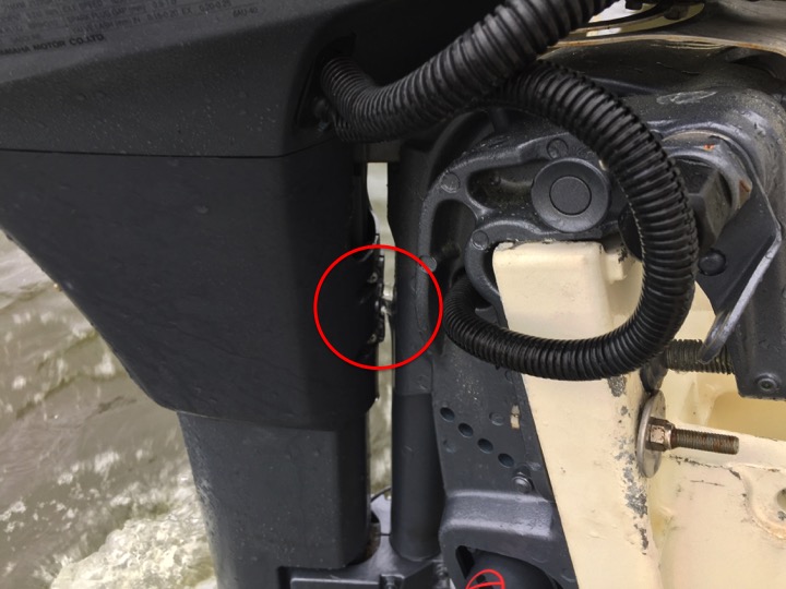

Someone on another forum found a cooling water pathway diagram for me so I attached that and the two photos I got of the holes I am talking about.
Thanks for the help.
