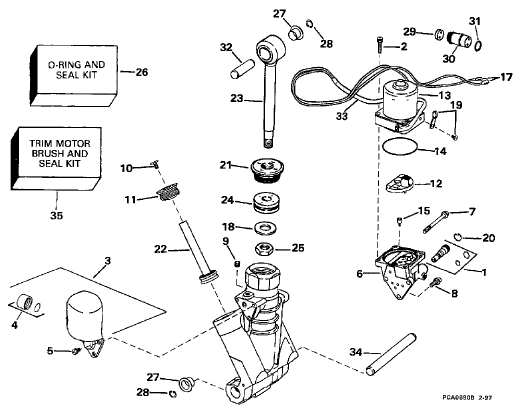

For many years the reservoir was on the starboard side of the T&T unit. As Joe said, if you lift the motor to it's highest position you should see a cylindrical unit on the right side and a large slotted screw or plug at the top. Simply remove the screw/plug, fill to overflowing as Joe said, reinstall screw/plug, run it up and down the full travel several times. Then, run it all the way up, remove the plug, and top off the fluid and you're done.
Here's a picture of the T&T unit from a 1997 50HP model. I'm willing to bet yours is identical. Item #4 should the filler plug you need to remove.
