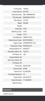

Here is what I know (attachment)
The dust is on the end opposite the water pump
Sounds like GM engine.-----Should be easy to find a replacement.-------But do a complete evaluation on boat and drive before spending any beer tokens ( $$$$ ) on this project.

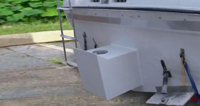

Single outboard brackets like the one below are cheapest. If you get a dual engine bracket, or one with a swim deck that will cost more. You just need to make sure the bracket matches the horsepower, so perhaps buy the bracket after the engine?

I like this approach.... Didn't know it was easy to convert to outboard. How would I find info on doing this?
Keep in mind this is only price competitive to replacing your engine if you are looking into a used, somewhat older unit. The new stuff is spendy! Make sure the area you plan to use the boat in will allow 2 stroke engines before you consider buying one of those.
What model of boat is it? Is it Fiberglass or Aluminum? The process will involve closing up the hole int the transom that was left behind when the outdrive comes out. You will likely want to reinforce it as well. Its a lot of labor and the resin is expensive, just things to look out for. Marine ply is not cheap either. The video below gives a quick overview of what the process is like without going to far in depth.
What kind of horsepower do you need? Is it a larger boat?
As far as where to get the bracket you could try ebay. For more detailed information you need to do a lot of research for yourself reading through threads of what other people have done. You may have to post a few specific questions when you get stuck. You will need to figure out the details for your specific situation.
