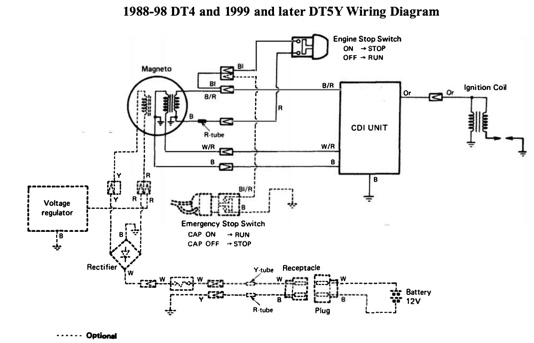

I am trying to identify the different parts of the ignition.
Under the Flywheel there is one coil which I believe is the Pickup or Pulsar coil
One cable goes from that to the Ignition coil and then onto the Sparkplug.
All the videos I have watched and manuals I've found on the internet indicate that there should also be a CDI in-between the Pickup coil and the ignition coil
Can anyone shed some light on this?
Also Suzuki don't make the Ignition coil for this model anymore. Can I use one from a different manufacture?
