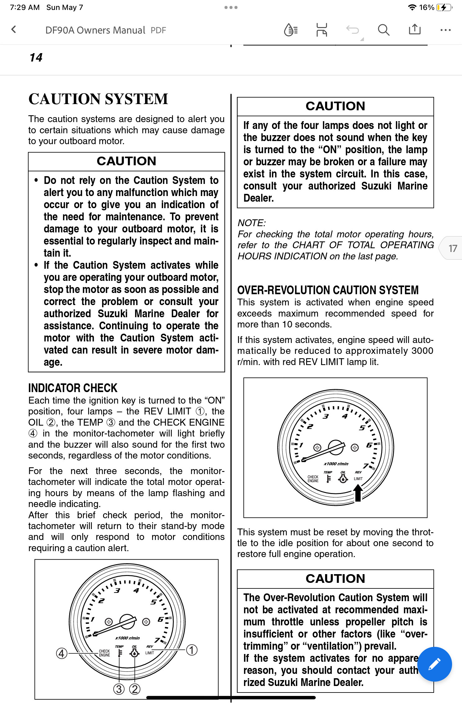

You probably hit your rev. limiter at about 6300rpms. Consult your owners manual. I can hit mine if I’m by myself and start trimming up.
Thanks for your reply! I’ve heard that from other Suzuki owners and that’s what I was thinking it was just wanted to make sure I wasnt pushing the motor too hard. I was also by myself. What does your motor do when you hit it? (I don’t have a tachometer to alert me)
I wouldn’t necessarily call it resistance. The engine will burp and fart and drop the revs to stay below the factory set limit until you back off on the throttle. Once I hit my rev. limiter I trim down a bit until I runs smoothly. I have never pushed the engine to see if it will drop to 3000rpm automatically as the manual states. If I add a passenger then I won’t hit the rev. limiter.
