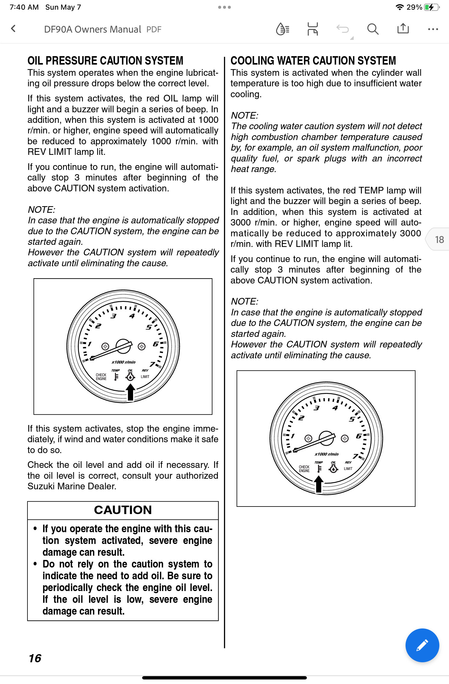

I have a Suzuki DF40A 2018 and i have this problem....
I Run a few, when i "ungear" sound One single beep and the motor stops. But if i star the ignition, it starts and run normaly.
If i go slow there are no problem, if i give speed for a few moments ( 40 or 50 deconds for instance) when i ungear.... The same.... One beep and shut dow...
Anyone can help me please ????
