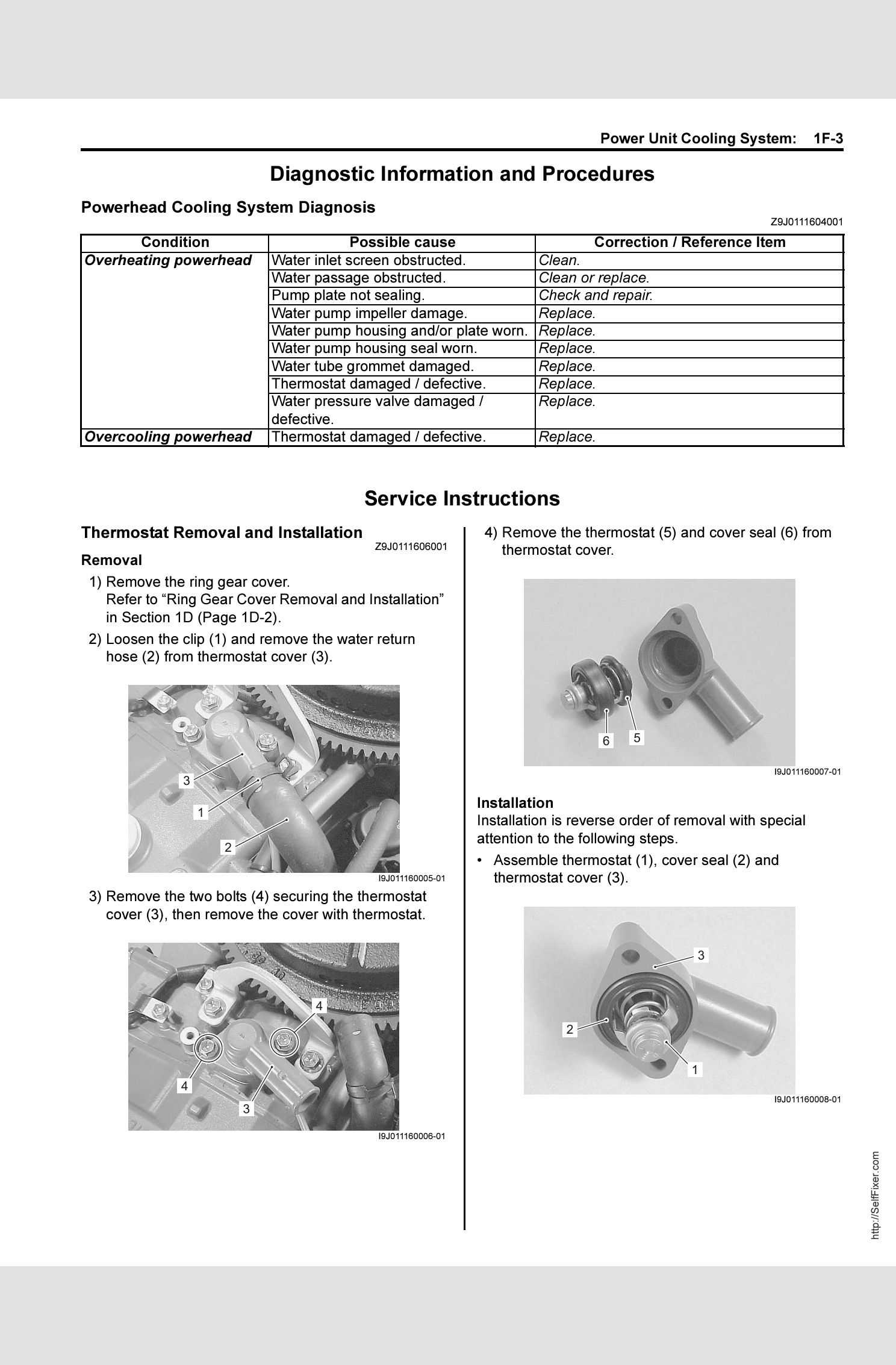

The thermostat was pulled out, but the error is still there. The pump impeller was replaced before the season during service. Additionally, the spark plugs were recently replaced because the engine started to work unevenly.

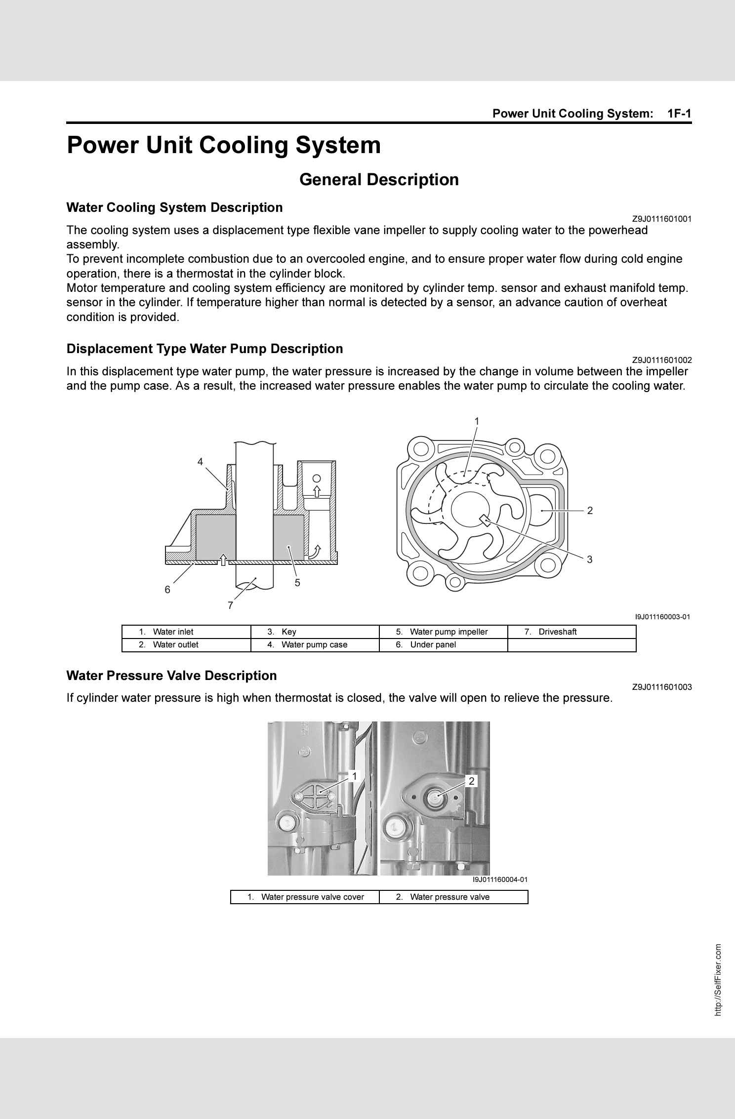

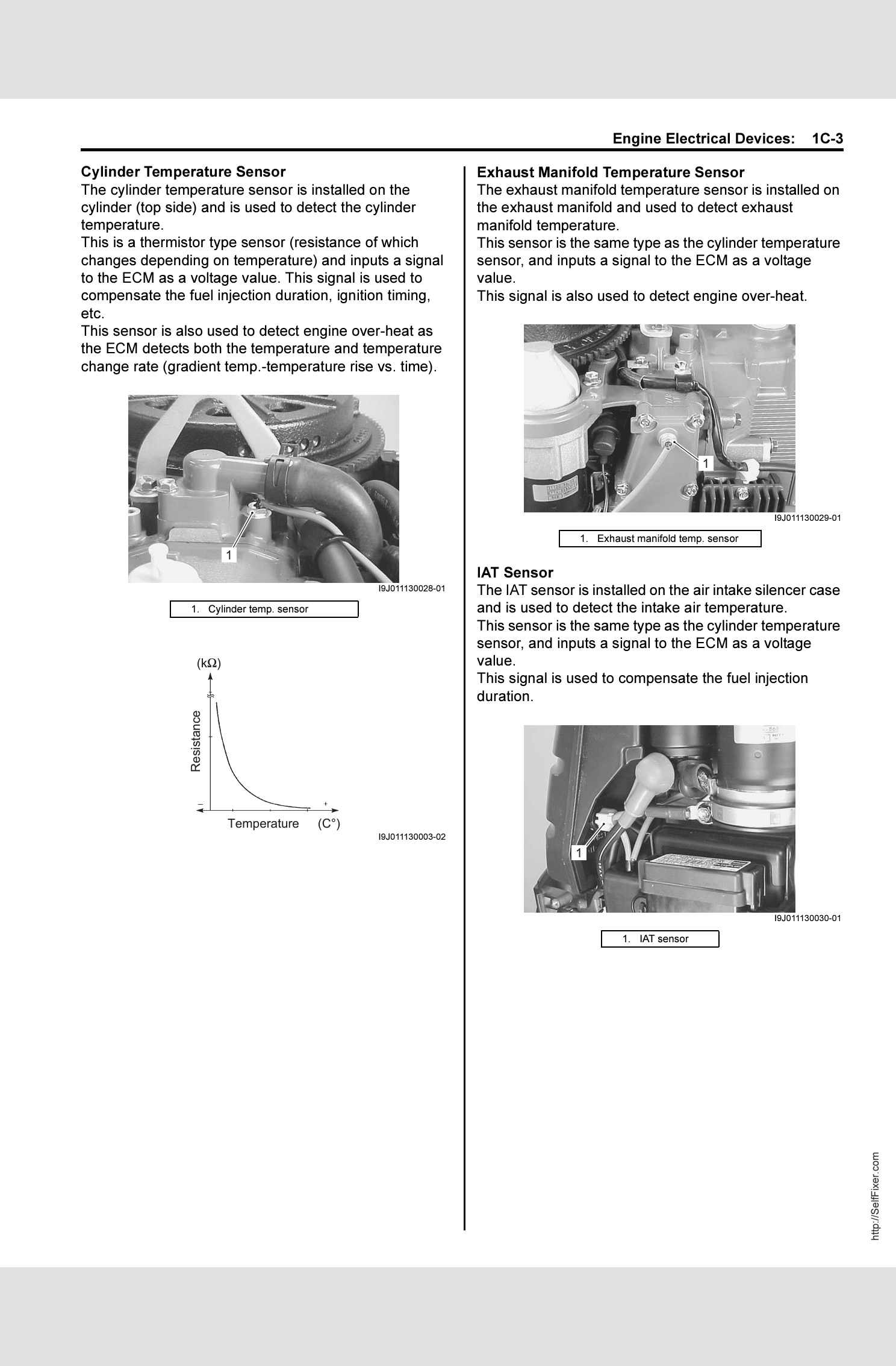

Where can I find the water pressure regulator and temperature sensor, does anyone have photos?

Thank you. I'll check.
The thermostat was pulled out. The pulled out thermostat also showed an error.
