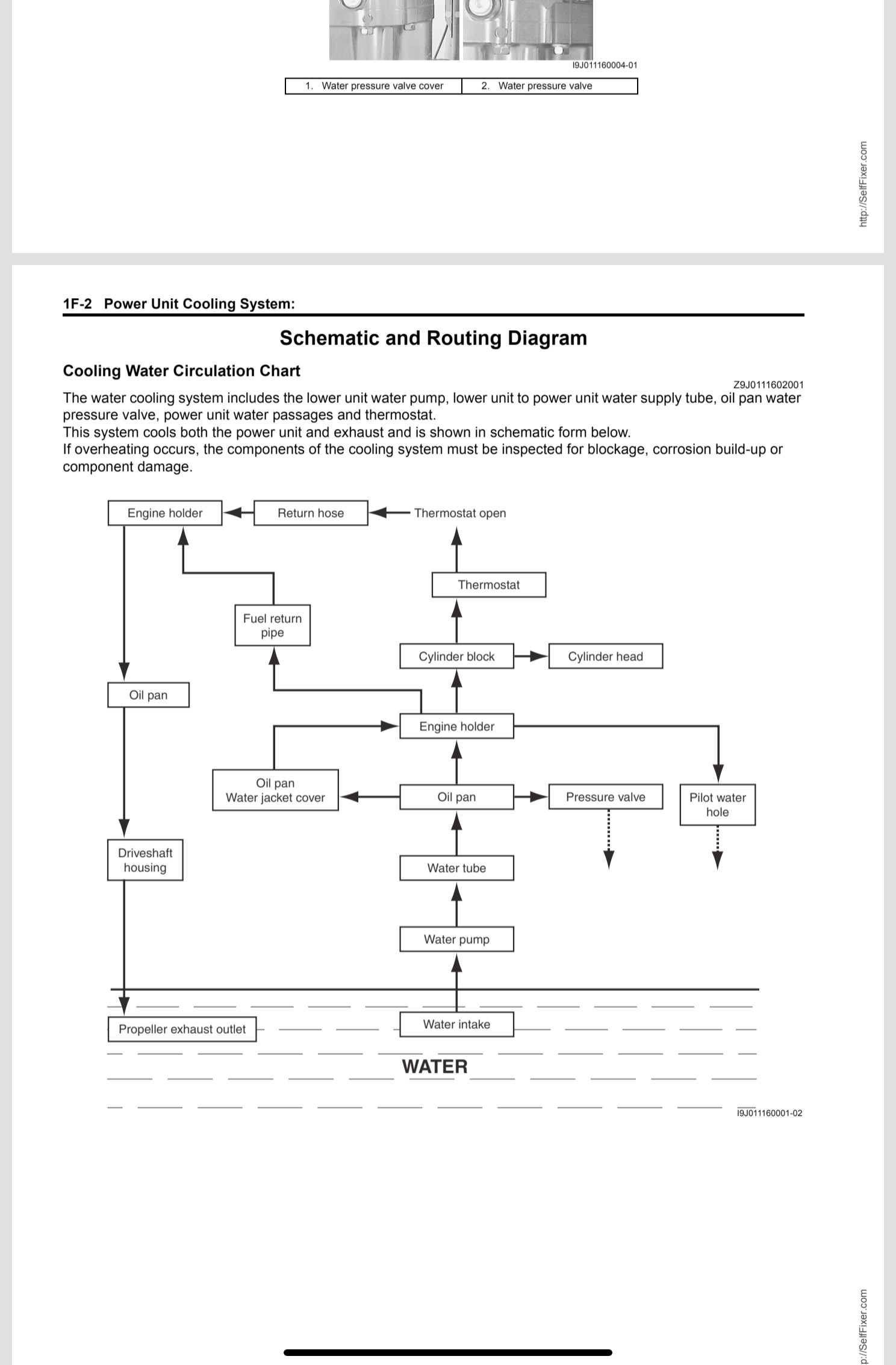

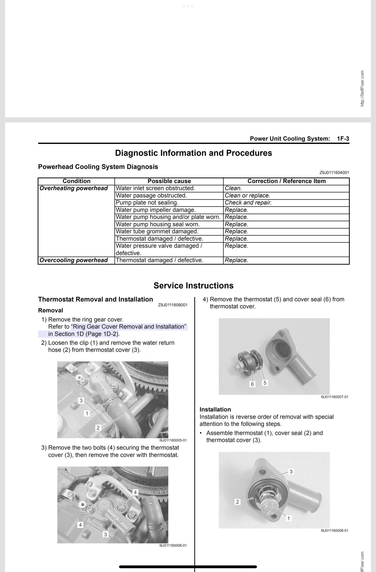

I would suggest you change the entire water pump assembly then you know the water pump is 100%. While you have the lower unit off look up inside and gently wiggle the water tube, it should be tight and firmly seated in the engine. Have read where the rubber grommet at the top of the water tube has deteriorated so much that it no longer seals to the engine. Being a salt water engine you could have corrosion/mineral deposits throughout the engine. A vinegar/salt away flush might be in order. Do you have a set of muffs to try? Nobody ever recommends muffs over barrel or actually having the engine in the water but using muffs would prove/disprove racerone’s theory. Not all muffs are created equal. With my 2009 DF90A I bungee cord the muffs on the lower unit tight, they want to slide off. Try hooking a garden hose to the flush ports(I have 2) with the engine OFF and see what kind of flow you get.
Screenshots from a 2009 DF90A service manual
Thanks. I found the diagram in the manual, but not the diagnostic page.
I did figure out the thermostat was bad. It was open at room temp, and should have been closed. Replaced that this morning. Ran the engine for a bit and it didn't overheat, but there is definite pressure in the return hose and it got hot quickly and the pulsing can be felt. That was noticed before the engine was hot enough for the thermostat to open. There was a small drip at the connection of the hose to the housing as well, I am guessing from the pressure. It peed just fine.
