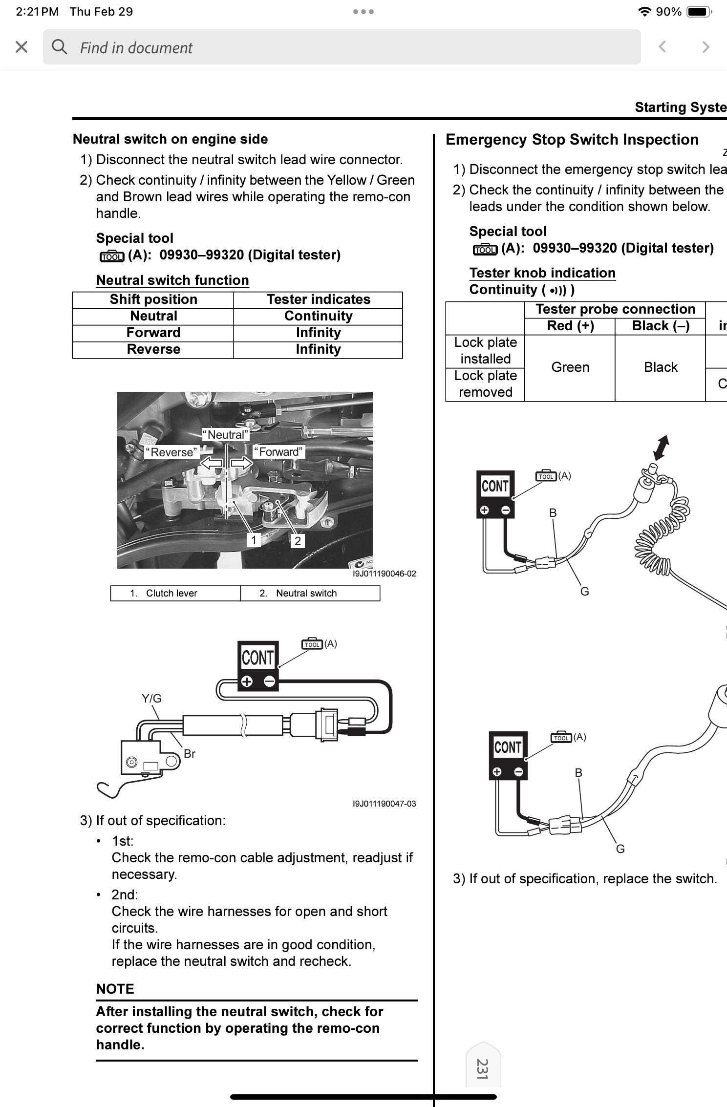

Swapped controls and the port remote will start and run the starboard motor. Starboard control will not run port motor. Have swopped ECM with no change. Have checked the three fuses I can see (2 on motor, 1 at remote), visually all wiring is intact from remote to motor and in the motor itself. Cleaned and refastened the ground connections. Nothing.
